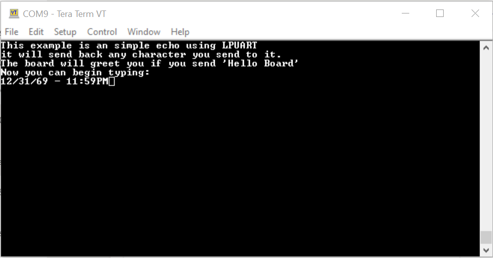

I have tried this using the example lpuart_echo_s32k144 from the SDK (if you don't have the SDK please check the following link), adding the following code I didn't have problems with the route:
  time_t rawtime;
  struct tm *info;
  char buffer[80];
  time( &rawtime );
  info = localtime( &rawtime );
  strftime(buffer,80,"%x - %I:%M%p", info);
  LPUART_DRV_SendDataBlocking(INST_LPUART1, (uint8_t *)buffer, 80, TIMEOUT);
I think this could be related to the project settings. Be sure that you're enabling the libraries (newlib/redlib).
For reference, I'm using S32 Design Studio for ARM (Version: 2.2)
I hope this helps you.
