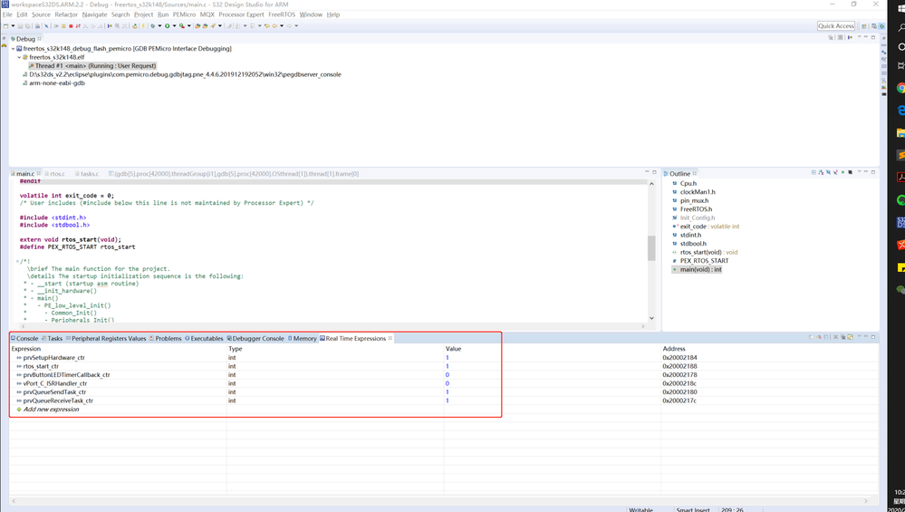

I' m working with s32k148-q176 EVB, I try to test FreeRTOS explame project,“freertos_s32k148”. But when i press the Button sw4(PIN: PTC13), the LED has no change. I add one parameter “ctr” in Interrupt function "vPort_C_ISRHandler()" ,which is in rtos.c file. I open Real Time Expressions, want to check if the interrupt ISR execute or not. When i press the Button sw4,my parameter “ctr ” is still 0.
I have no idea, how to solve it.
Here is Debug window.
Can anyone help me?
Thanks.
Liu

This problem is not about software(code). I check the connection of switch 3 and 4 . There are some hardware problems. These two switch cannot work. I have already contactednxp after-sales service department staff.

I tried this demo example and add a variable similarly
When press SW4 red LED is ON and I see vPort_C_ISRHandler_cnt updating in Real Time Expression window.
Be sure you do not halt the Expression Values Refresh.
