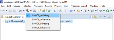

am trying to use a Segger J-Link debugger with ‘S32 Design Studio for Arm IDE’.
I am using a ‘UCANS32K146’ evaluation board which has a S32K146 processor.
I set a breakpoint as shown...
But the debugger does not seem to run to or stop at the break point, it seems to be in reset ?
Below is a copy of the console messages...

How are you building the application? We are seeing there are different build configurations.

I build as shown in the screenshot below (Node_A_Debug)...

The SDK that you are trying to import into S32DS for ARM v2.2 is not compatible with that IDE, it is compatible with S32 Design Studio v3.4. That should be why you are seeing that error.
The one that it is compatible with S32DS for ARM v2.2 should be provided with the IDE, image below:
Within the examples provided with the SDK, the following configurations should be provided:
In our specific case, we use the FreeRTOS project as an example. This should be ready to use.
