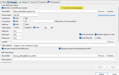

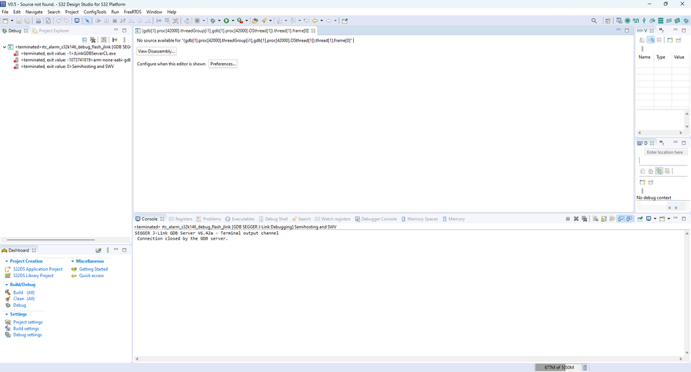

I'm facing issue with S32 Design Studio V3.4, when I try to debug the issue occur during that is
No source available for "(gdb[1].proc[42000].threadGroup[i1],gdb[1].proc[42000].OSthread[1]).thread[1].frame[0]"DisassemblyDisassembly
after reinstalling the Design studio, the problem is solved for some time, but again same thing happens.
Please let me know if anyone have solution this.
S32DS-S32PLATFORM S32K146EVB #JFLASH#Debugging

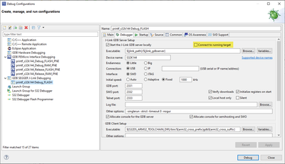

Hi @P007,
Could you share your debug configurations? Is this issue only present in your project? Or is it present on the examples as well, please test this.

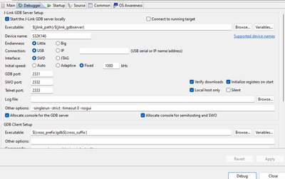

P007
@Julián_AragónM
the issue is observed on both my code and example code
Configurations

Julián_AragónM
Hi @P007,
Are you able to connect to target without uploading an image?
If so, please try and stop the MCU to see if it is stuck somewhere in application.
Also, you could try to reset or erase the chip from the JLink flash tool (e.g. JFlash.exe or JFlashLite.exe, you can find it in the installation directory of Segger J-Link).
If these still do not work, please try another MCU or debug probe to see if the issue is within the hardware.
