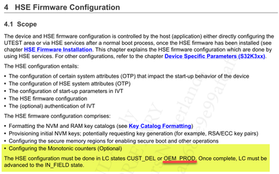

Hi NXP,
    i tried hse monotonic counter under LC = OEM environment, it could be inited , increase and re-init.
   my question is,  i want implmement a program counter function, record operation counter.  i want to make it init  ONLY once and increase, CAN'T be re-init to 0 in LC = OEM,
1.  is monotonic suitable for this?
2. if not, is there any other feature function suitable for this case?
1,533件の閲覧回数
lukaszadrapa
Hi @victory
Please take a look at following screenshots from the HSE FW RM:
Lukas
1 返信
1,534件の閲覧回数
lukaszadrapa
Hi @victory
Lukas
