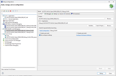

I'm trying to flash and debug the sample program for the NXP S32K324 Triple Permanent Magnet Synchronous Motor Control Reference Design Board. I'm using a SEGGER J-Link Base debugger, the debugger can detect the core - I tried it via the JLink commander as well, but when I try to launch the debug session it always throws an error saying the JLink GDB Server is unable to halt the core. Here is a snapshot of the complete log.

yeshvanth-m
So the issue was with the board. This issue no longer occurs, but now there's another issue:
Any idea why this error is popping up? I have built both projects for the M7 cores.
10,379 Views
yeshvanth-m
I restored defaults in the debug window and it seems to be working now.

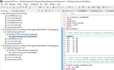

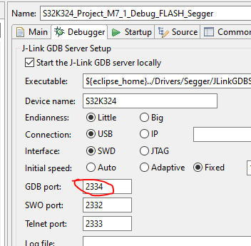

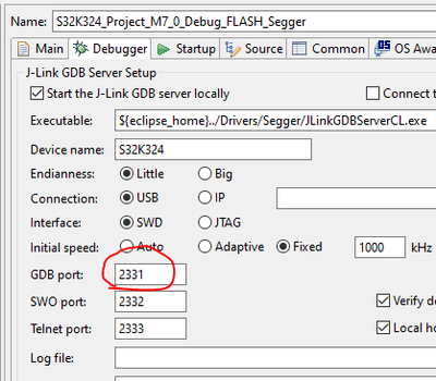

Jeremy_He
Could you try update the newest Jlink driver and make sure it gets updated in the S32DS installation folder.
Jeremy_He_0-1709614780998.pngJeremy_He_0-1709614780998.pngJeremy_He_1-1709614789779.pngJeremy_He_1-1709614789779.png
This is the log when I debug S32K324 with Jlink at my side. And make sure the GDB port of the 2 core debug instance need to be different.

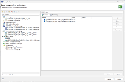

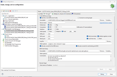

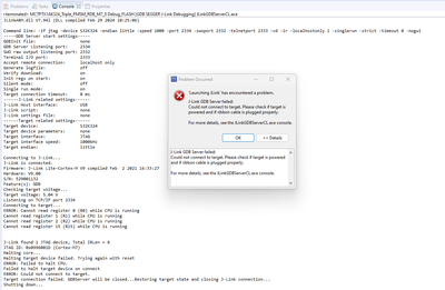

yeshvanth-m
Hi Jeremy,
Thanks for your response. But the problem still exists. I will provide all the configurations I used for better understanding.
yeshvanthm_1-1709692201796.pngyeshvanthm_1-1709692201796.pngyeshvanthm_2-1709692219984.pngyeshvanthm_2-1709692219984.png
With SWD and port ID 2334 as you suggested I get this error:
Same error with JTAG as well
What code is flashed at the factory? Is it something to do with corrupted code? Not sure about it.
