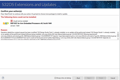

Dear Team,
I am facing the below issues for S32 Design Studio for S32 Platform v3.4 (Os: Windows)
1. In S32 design studio while tiring to open a new project unable to see process details. Please check the below SS for reference.
2. For this issue while trying to install S32k1xx development package getting below error and is unable to process further.
Reason:
Operation detailsSoftware being installed: com.nxp.s32ds.s32k1.dev.feature.feature.group 1.0.0.202106101451 Missing requirement: com.nxp.s32ds.brc.arm.tools.gcc92_1649.feature.feature.group 1.0.0.202005201157 requires 'org.eclipse.equinox.p2.iu; com.nxp.s32ds.brc.arm.earmv7.gcc92_1649.feature.feature.group [9.2.0.202005201157,9.2.0.202005201157]' but it could not be found Cannot satisfy dependency: com.nxp.s32ds.s32k1.dev.feature.feature.group 1.0.0.202106101451 depends on: org.eclipse.equinox.p2.iu; com.nxp.s32ds.brc.arm.tools.gcc92_1649.feature.feature.group 0.0.0
Please check the above issue and provide the fix for creating a new project.
Note: We are tiring to create projects for the S32k144 series Mcus.

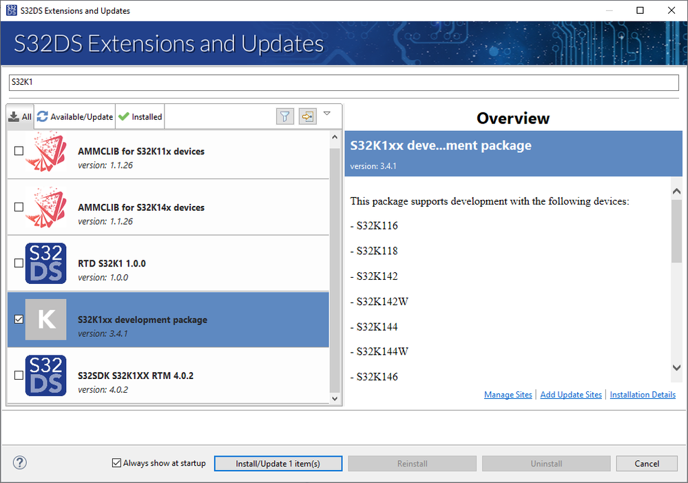

Hi Pratyay,
After install the S32K1xx development package, you should be able to create S32K1x project.
Would you please uninstall the S32DS3.4 and install it again?  I tried to uninstall and reinstall yesterday, and I did not encounter the problem(Missing requirement) you mentioned.
Robin
