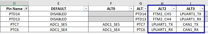

We are using S32K1XX controller in our project.
I used the example code of LPUART1 and tested on the Evaluation board.
same configuration of LPUART1 is used for the different pins.
 I have changed the pin configuration
void PORT_init (void) {
PCC->PCCn[PCC_PORTD_INDEX ]|=PCC_PCCn_CGC_MASK; /* Enable clock for PORTC */
PORTD->PCR[13]|=PORT_PCR_MUX(2); /* Port C6: MUX = ALT2,UART1 TX */
PORTD->PCR[14]|=PORT_PCR_MUX(2); /* Port C7: MUX = ALT2,UART1 RX */

we connected the K line board and tried  with PortD pin  configuration, but it is not working.
we have set the TXINV and RXINV bit before enabling the TE and RE bits and enable the TE and RE.
we updated the value to data register but data register is not updating.

Please see S32K144_IO_Signal_Description_Input_Multiplexing.xlsx file that is attached to the RM.
You need to set ALT3 function of PTD13/PTD14.
