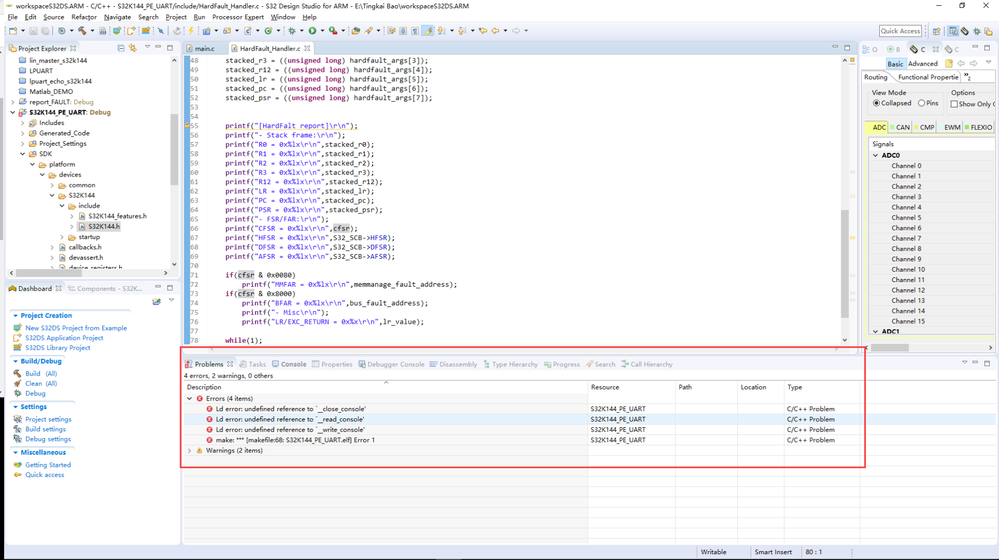

I am using a new example 'hello_world_s32k144' form 'S32K14x EAR SDK v0.8.6' and it can work normally.
But when I add debug HardFault's code to the project,the project will be reported follow error:
When I comment on the 'printf' function, no error occurs.What is the cause of the error,the code as follow:

Thank  you for your answer,I have already solve the problem by change “Target Porcessor”->"Libraries support" ewl_c to newlib no I/O in "Project Properties".

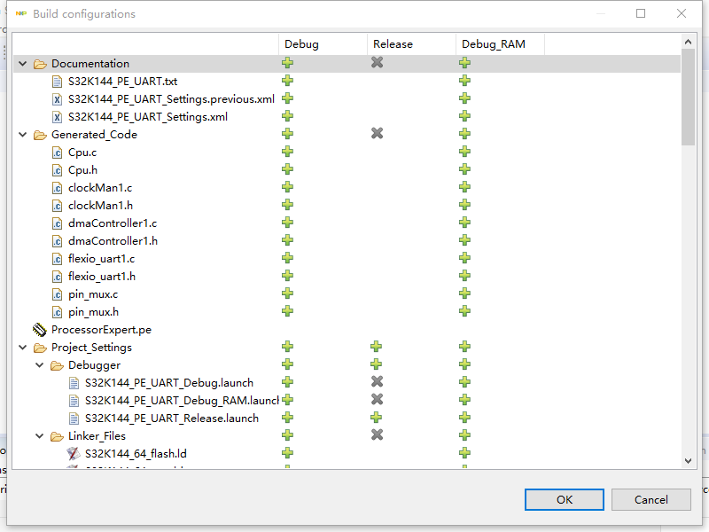

Now I have a new ERROR about Processor Expert,the icon is gray and can not be loaded.
I have tried to use Build configurations explorer, it's not work.

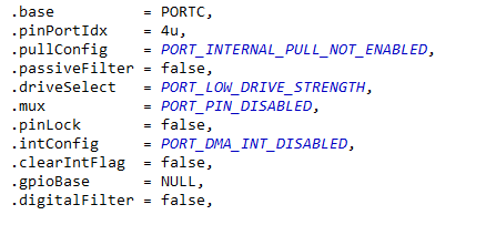

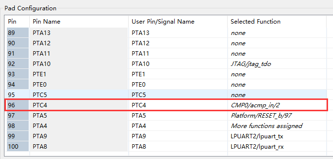

And when I use the "PINS_DRV_Init" function in "pin_mux:PinSettings" Components .
The IDE crashes when it runs on pin 96 (PTC4),does anyone know the solution?

razva_tilimpea
I suppose that you don't have clock enable for PORT C. Check clock manager configuration.
