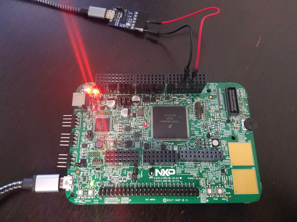

I am using the lpuart_echo_s32k148/ uart example as my base project. I am using the main while loop like the following,
while(1)
    LPUART_DRV_ReceiveData(INST_LPUART1, buffer, 1UL);
    while(LPUART_DRV_GetReceiveStatus(INST_LPUART1, &bytesRemaining) != STATUS_SUCCESS);
   /* Send data */
    LPUART_DRV_SendData(INST_LPUART1, buffer, 1UL);
   while(LPUART_DRV_GetTransmitStatus(INST_LPUART1, &bytesRemaining) != STATUS_SUCCESS);
Now, according to the Quick Reference Guide, LPUART1_TX is on PTC7 and LPUART_RX is on PTC6.
I am able to transmit characters from the PTC7 pin and I can verify the characters are transmitted via connecting it to an FTDI module with a wire.
The problem is I am not able to receive data from the PTC6 pin. Using an FTDI module to transmit characters to that pin does not do anything.
I have also noticed that the RX pin has a voltage level of 5 --- wondering if this has anything to do with it?
I am also able to send and receive characters from the serial terminal via USB. But I need to be able to sned and receive via the rx and tx pins.
Any tips? Thanks!

Hello Ryan,
The lpuart_echo_s32k148 example expects the LF at the end of the message. Probably the terminal sends it and that is why it is working.
Please, could you check it?

Hi Diana, I checked the output of the module that I am using to transmit data to the S32 board. It does include an LF at the end of the message. I have included a picture of an example message being sent from the module and also a picture of the board with the transmitter connected to the reception pin. This message being sent is never received on the S32 board.image.png

razva_tilimpea
FTDI converter is not needed. You can use OpenSDA from the board. My theory is that you can't receive date due to a short circuit between your FTDI and OpenSDA ( FTDI can't control the line because OpenSDA pull the line because he doesn't have anything to send on the line).
Razvan
