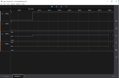

Hello everyone,
I am currently working with the S32K344 (HVBMS-K344-BMU) microcontroller on S32DS and utilizing FreeRTOS in my project. I have recently added the UART component to the MCAL layer to enable UART communication.
However, I am facing an issue with the UART functionality.

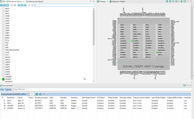

To set up the UART, I have configured the routing board accordingly in the schematic.
Additionally, I have initialized the UART as follows:
/* Initialize the UART driver */
Uart_Init(NULL_PTR);
In order to test the UART functionality, I performed a simple example:
printf("UART\n");// Example data to send
const char *dataToSend = "Hello, UART!";
// Send data synchronously
Uart_SyncSend(UART_CHANNEL, (const uint8_t *)dataToSend, sizeof(dataToSend), 1000);vTaskDelay(pdMS_TO_TICKS(10));
However, when I sniff the pins using an oscilloscope, I am not receiving any data except for a transition from low to high.
I would appreciate any insights or suggestions on how to troubleshoot this issue and get the UART communication working correctly. Thank you in advance for your help!

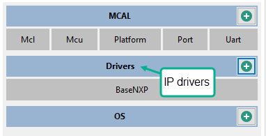

What do you mean by an IP module? RTD software provides low-level drivers (IP)
and high-level drivers (MCAL). MCAL provides APIs compliant with AUTOSAR and IP provides APIs with direct access to the hardware.

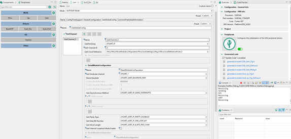

As you mentioned above, it is not recommended to use IP but the training that you sent use IP , also the example is empty . I have attempted various methods, some of which were quite unconventional. Here is a sample of my work:

I made a quick review of your configurations and these are my comments:
- Use Port and Dio instead of Siul2_Dio and Siul2_Port.
- Add all the pins configured in the Pins tool to the Port (LED 1, LED 2, UART TX, and UART RX) and Dio (LED 1 and LED 2) configurations of the peripherals tool.
- As you are using the UART with interrupts, configure the interrupt in the Platform driver.
Please use as a reference the Uart_example

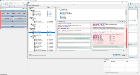

AchrafOukheir
hi @VaneB

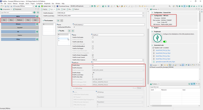

Thank you for reviewing my configuration. As you suggested, based on the UART inspiration, they used PORT and Siul2_port, which combines the use of mcal and drivers.
However, in my example, when I attempted the same configuration, I noticed that the user pin and port configurations were deleted, as shown in the picture you provided.
Maybe This could be due to a different SDK being used ?. because In my example, I used an SDK that had the FreeRTOS operating system. It's possible that the configuration method may differ when using this SDK !!.
To clarify the configuration or provide guidance on how to configure ports and pins for LEDs and UART RX/TX, could you please provide me with the picture or details of my example you are referring to will help me better understand the specific context and provide you with accurate assistance.
Additionally, when it comes to port configuration, I don't have the same level of control as the UART example. I believe there might be a specific SDK or a button  that needs to be used to enable configuration. Here's the difference between the UART example and my example, based on the FreeRTOS SDKs.
UART Example :
My example :

VaneB
Hi @AchrafOukheir
According to the provided images you are missing the value of PortPin Mscr. The following formula can obtain this value:
PortPin Mscr = PinId + PortId∗32
Where:
PortId is the numeric identifier of the port. Symbolic names will be generated for each port pin ID for the pins used for configuration.
PinId is in order of the selected pin in the port. On the S32K3 platform, we have 32 pins per port, so the range of PortPinId is: 0-31.
So, for example, PortPin Mscr (PTC7) = 7 + 2∗32 = 71

VaneB
Hi @AchrafOukheir
Siul2_Port is added by default, so for the MCAL projects it needs to be deleted. The configuration of the pins can still be found in the struct named g_pin_mux_InitConfigArr.
Also, you must initialize all pins using the Port driver by calling Port_Init() before Uart_Init().

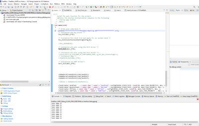

Just to make sure it will work. but unfortunately, I think there is a probeleme in the initialisation:
Port_init(NULL_PTR);
when I initialise the port the programme stop working.

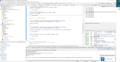

AchrafOukheir
Hi @VaneB ,

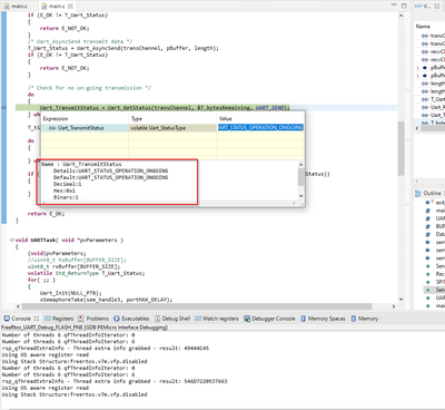

It appears that the issue does not originate from the UART_getStatus() function itself, but rather from the consistent return status of UART_STATUS_OPERATION_ONGOING. Regardless of whether I tried the NXP examples or my own implementation, the UART consistently returns this value.
Based on my observations, it seems that the UART is continuously busy. This behavior persists despite my attempts to resolve the issue. To provide you with a better understanding of the problem, I have attached a screenshot showing the exact location where the problem occurs during debugging.
Furthermore, I have included the project for your reference. Feel free to take a look and provide any insights or suggestions you may have.
I appreciate any assistance you can offer in resolving this issue.

VaneB
Hi @AchrafOukheir
To ensure that the UART modules work without any problem, please test the UART example provided with the RTDs. If you still present the same behavior let me know.
Also, an observation is that we do not recommend combining IP modules with MCAL modules.
