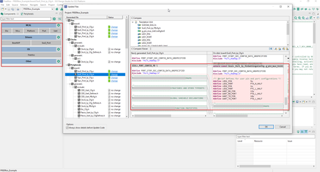

Thank you for reviewing my configuration. As you suggested, based on the UART inspiration, they used PORT and Siul2_port, which combines the use of mcal and drivers.
However, in my example, when I attempted the same configuration, I noticed that the user pin and port configurations were deleted, as shown in the picture you provided.
Maybe This could be due to a different SDK being used ?. because In my example, I used an SDK that had the FreeRTOS operating system. It's possible that the configuration method may differ when using this SDK !!.
To clarify the configuration or provide guidance on how to configure ports and pins for LEDs and UART RX/TX, could you please provide me with the picture or details of my example you are referring to will help me better understand the specific context and provide you with accurate assistance.
Additionally, when it comes to port configuration, I don't have the same level of control as the UART example. I believe there might be a specific SDK or a button  that needs to be used to enable configuration. Here's the difference between the UART example and my example, based on the FreeRTOS SDKs.

According to the provided images you are missing the value of PortPin Mscr. The following formula can obtain this value:
PortPin Mscr = PinId + PortId∗32
Where:
PortId is the numeric identifier of the port. Symbolic names will be generated for each port pin ID for the pins used for configuration.
PinId is in order of the selected pin in the port. On the S32K3 platform, we have 32 pins per port, so the range of PortPinId is: 0-31.
So, for example, PortPin Mscr (PTC7) = 7 + 2∗32 = 71

Hi @AchrafOukheir
Siul2_Port is added by default, so for the MCAL projects it needs to be deleted. The configuration of the pins can still be found in the struct named g_pin_mux_InitConfigArr.
Also, you must initialize all pins using the Port driver by calling Port_Init() before Uart_Init().

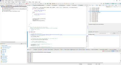

It appears that the issue does not originate from the UART_getStatus() function itself, but rather from the consistent return status of UART_STATUS_OPERATION_ONGOING. Regardless of whether I tried the NXP examples or my own implementation, the UART consistently returns this value.
Based on my observations, it seems that the UART is continuously busy. This behavior persists despite my attempts to resolve the issue. To provide you with a better understanding of the problem, I have attached a screenshot showing the exact location where the problem occurs during debugging.
Furthermore, I have included the project for your reference. Feel free to take a look and provide any insights or suggestions you may have.
I appreciate any assistance you can offer in resolving this issue.
