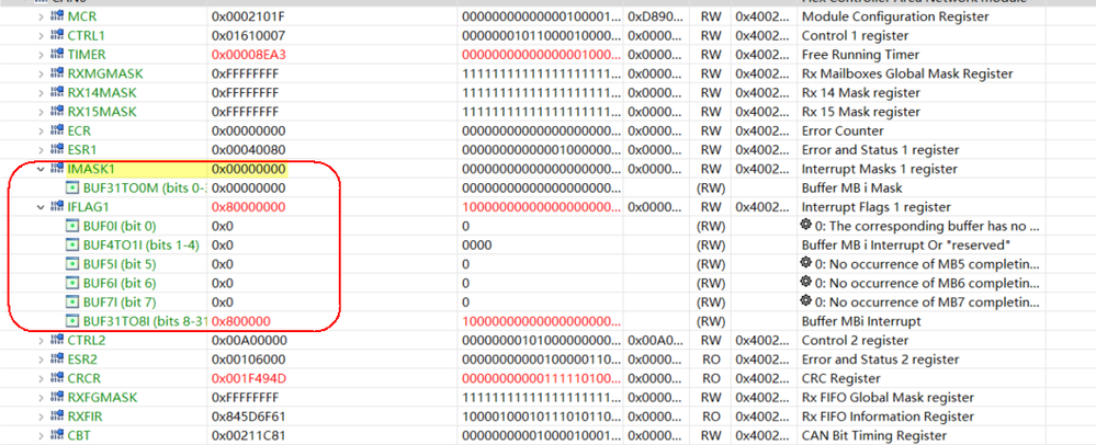

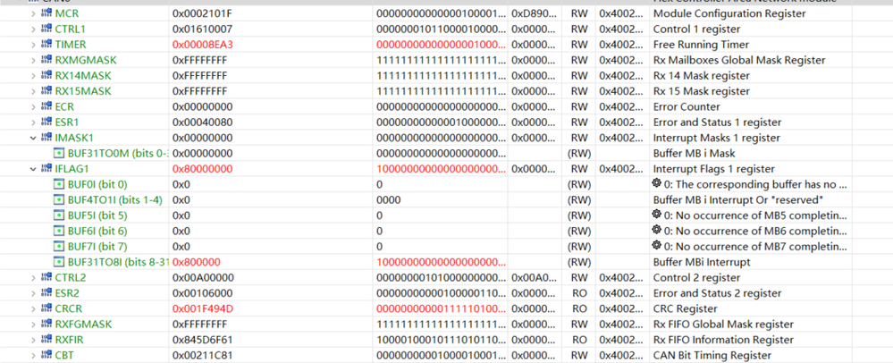

There is no trigger interrupt after sending the message. Is there any problem with my can initialization?
SOFT:  S32DS for ARM 2018 R1.
CHIP:S32K118
send first message(Success):
send second message(Failure):
Thank you for your reply!!!

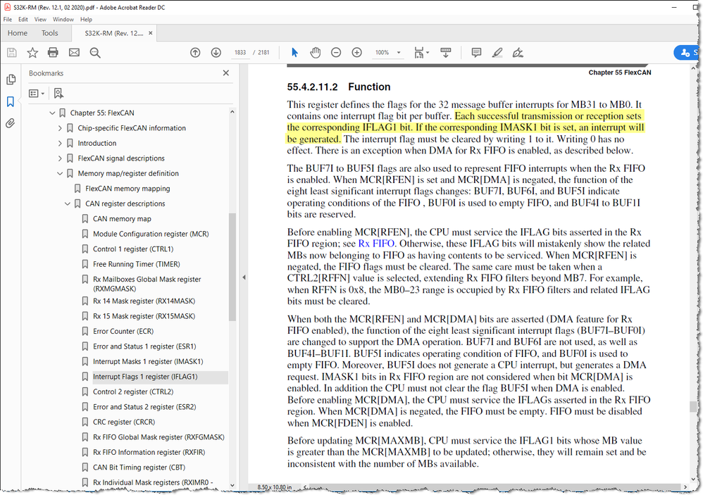

Hi  Zhibing,
Seems that you forgot set the corresponding IMASK1 bit.
Robin

shengzhibing
HI Robin_Shen:
My problem has been solved,I forgot to enable FlexCAN interrupts (^_^) and I did not set imask bit .
