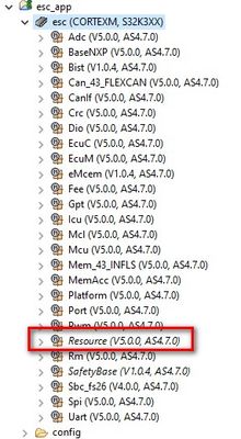

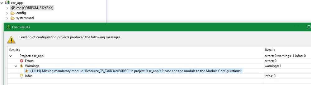

I always get the warning 11115 in Tresos that the Resource module is missing:
Project: esc_app<br>Missing mandatory module "Resource_TS_T40D34M30I0R0" in project "esc_app": Please add the module to the Module Configurations.
I have the 5.0.0 version installed. So, why is it still complaining about the old one?
It has no impact on functionality, it is just annoying. Is it perhaps an EB Tresos issue?
I searched for the Resource_TS_T40D34M30I0R0 string and cannot find it anywhere, except in the ".tresoslog" file.

I'm not sure if this is an issue on EB Tresos or our RTD SW. It may be an issue regarding multiple versions inside the plugins folder.
Do you have multiple versions for the RTD installed?

yes, I have:
(ignore that in this screenshot version 3 is used and not 5, it is a different branch state currently).
This different version shouldn't matter. For every other component also 3 different versions are shown, only one is selected, and no component is reporting a warning, except "Resource".
