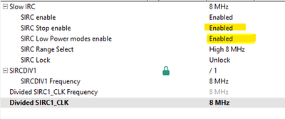

I think I am entering VLPS mode because:
     -The consumption drops from 0.74mA to 0.60mA.
     -Without enabling the SIRC clock to function in sleep mode, it does not wake up again:Captura de pantalla 2025-02-26 181230.pngCaptura de pantalla 2025-02-26 181230.png

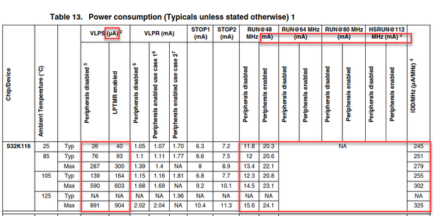

that's not a big current drop indeed. If you see DS values, VLPS current are specified in uAmps
How I have already answered, FlexCAN needs to be turned off completely.

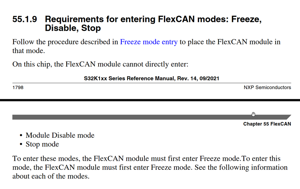

That is, does the FlexCAN have to be turned off by code? Doesn't it automatically turn off when entering VLPS? Do any other resources need to be disabled before entering VLPS, such as a clock or another peripheral, or does the VLPS mode handle it automatically?
And regarding the function I sent you, is it correct? I wrote it exactly as stated in the RM manual, but I’m not sure if I’m missing anything else.
3,474 Views
davidtosenovjan
It is described in RM, section 55.1.9.
