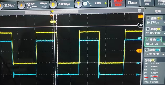

Problem description: Adding an instruction to reverse GPIO at the input of the FTM2_Ch0uCh1_IRQHandler() interrupt function, it was found that the capture trigger time can be delayed by up to 3.2us compared to the captured signal. I only set the interrupt priority of "FTM2_Ch0_Ch1_IRQHandler" to the highest priority 0. As shown in the following
figure:
CH1 channel (yellow waveform): FTM2 captures interrupt reversal IO port;
CH2 channel (blue waveform): periodic square wave generated by the signal generator;

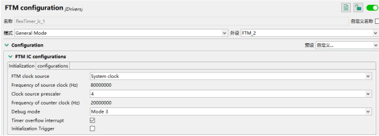

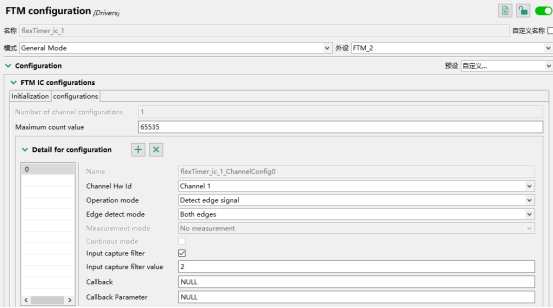

My FTM2 configuration is as follows:
Configure reference information, refer to this image:
Specific configuration information of FTM2:
