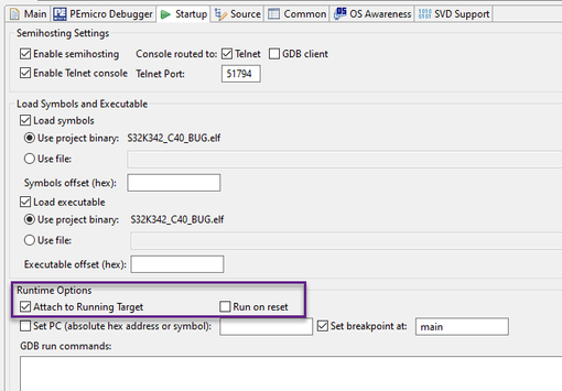

danielmartynek
Hi @anakha,
What debugger do you have?
Multilink can be attached to the running MCU stuck in the exception handler.
Make sure the clocks are configured precisely to one of the clock options.
