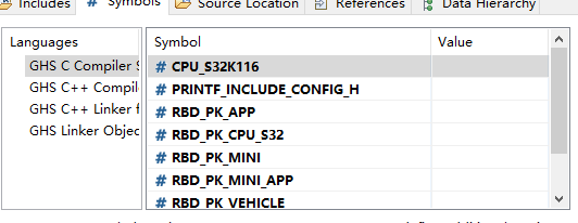

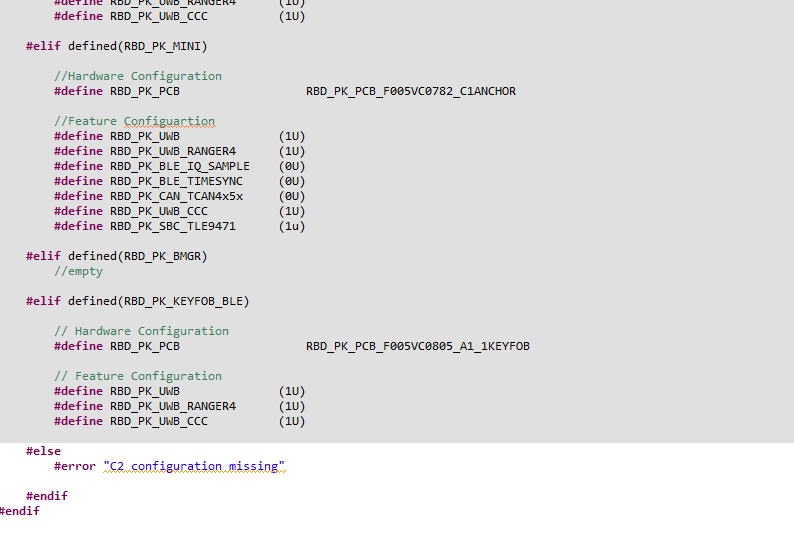

I have a project in which a macro "RBD_PK_MINI" is defined in the "properties->C/C++ General->Paths and Symbols" of the project, but the piece of symbols in the code is gray, and the jump of "Ctrk+cliked" cannot be realized.I don't seem to have a definition, but I've defined it.This is a project imported from somewhere else.
This problem does not appear on my other computer, but it is the same project, I did not change it, I hope to get help, thank!

Hi Elaina,
try to create new workspace and import your project into it.
