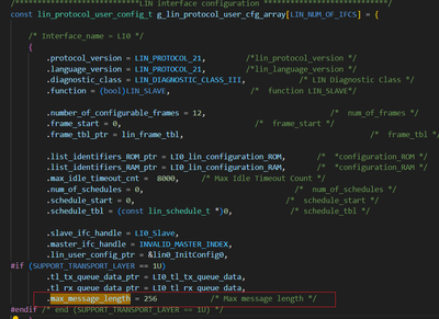

    The LIN protocol stack generated in S32DS has a limit on the maximum message length. Where can we find the basis for this?When sending data exceeding 256 bytes, a timeout occurs. It seems that the protocol stack does not handle the situation of extremely long data.

    The used MCU is the S32K1xx series. However, the SDK package does not have clear information. I checked the configuration in the S32DS and indeed, the length can be adjusted.

Hi @ZEROOO,
Which S32Kxxx device are you using, and what versions of the SDK/RTD and LIN Stack are you working with?
