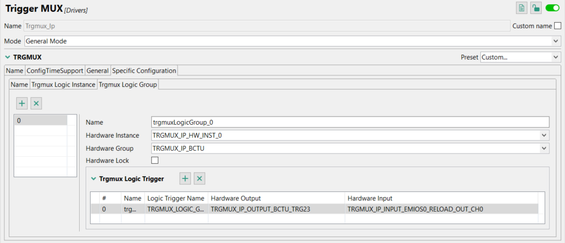

I am trying to test the TRGMUX (input-output) functionality,
1) The output?
I am triggering  the emios_gpt every 25 us i have assigned the input into the TRGMUX as seen below:Skærmbillede 2024-03-05 182425.pngSkærmbillede 2024-03-05 182425.png
pin configurations: I have used the trgmux out1 -PTD-0
I display the input signal from emios_gpt and the output signal from the TRGMUX  on the oscilloscope.
The issue I am seeing is that the emios_gpt signal frequency is 20 kHz and 50 duty cycle.
and the TRGMUX output signal is 40 kHz and 0,03 duty cycle.
The output frequency for the TRGMUX is correct, but I was expecting to get the same signal the has been inputted. what do I miss here ??

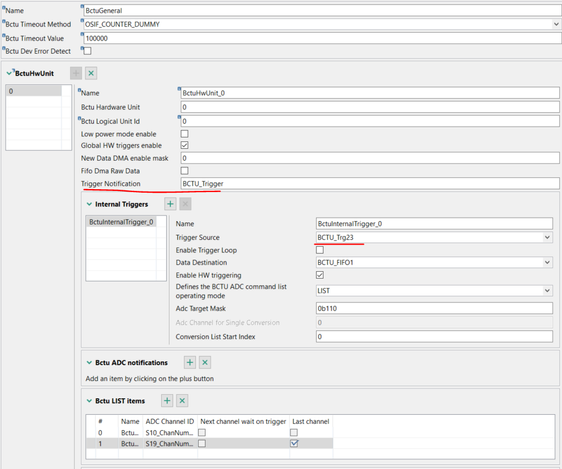

Senlent
Hi@Ayaz
First of all, I'm sorry, there are no more details about this part in the data sheet, so I don't have the ability to explain it clearly to you.
However, I tested using->
TRGMUX_IP_INPUT_EMIOS0_RELOAD_OUT_CH0->TRGMUX->TRGMUX_IP_OUTPUT_BCTU_TRG23->BCTU, and the results were as expected.
Here I suggest you use PWM->TRGMUX->BCTU to observe more details.
For example you can configure it like this:
Chx_PWM->TRGMUX_IP_INPUT_EMIOS0_IPP_CHx->TRGMUX->TRGMUX_IP_OUTPUT_BCTU_TRG23->BCTU.
Chx_PWM->TRGMUX_IP_INPUT_EMIOS0_IPP_CHx->TRGMUX->TRGMUX_IP_OUTPUT_SIUL2_0_3_OUTx
