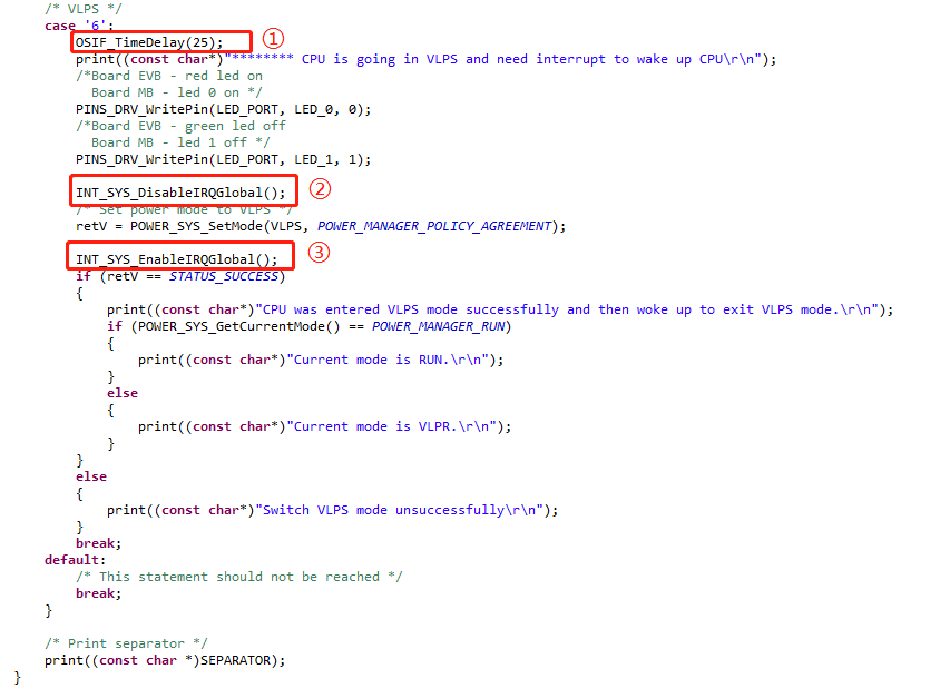

    SysTick  will affect entering into VLPS?
   when I am debugging,the SysTick  is tunned off before entering VLPS,it stops。
   when I am debugging,the SysTick  isn't tunned off before entering VLPS,it do not stops,why?

I have tested the power_mode_switch_s32k144 example and when I enable the OSIF_TimeDelay(25); under the
"case '6':" in the code. I was able to enter into VLPS mode without any problem.
No, the SysTick is not the wakeup source when you are not in debug mode. Please, make sure, the debugger is not attached.

      So,you only add OSIF_TimeDelay(25) under the "case '6': ",you can try it below:
Add the code of "① ② ③ ", It will exit the VLPS mode directly. It didn't work as I expected.
Add the code of "② ③ ", It wll work normally。

I have tested the same code as you shared with me and VLPS works as expected. I was able to enter into VLPS with additional code "① ② ③ ".
I assume the root cause of your issue is that the debugger is still attached. Important note: the power cycle is required after debugging.
Also, I recommend you to use the newest SDK version S32 Design Studio for ARM 2018.R1 - Update 10 available
I hope it helps. If not, could you please share your project?

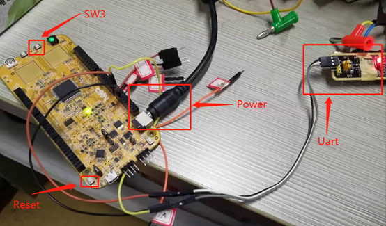

      Below is the environment  I tested:

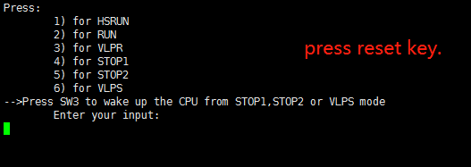

1)Press Reset Key, See below:

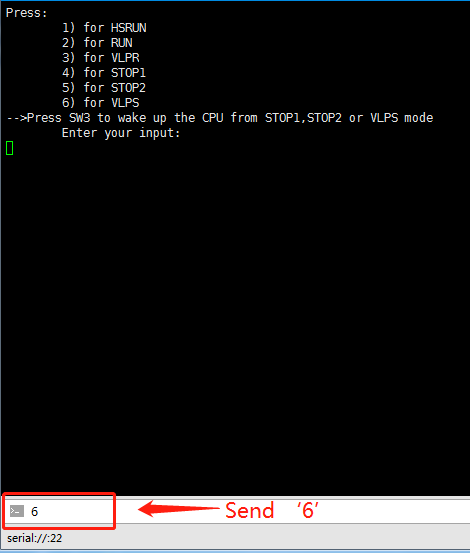

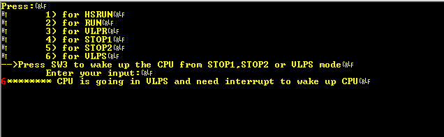

2)Prepare to send ‘6’ ,Select “6) for VLPS”, see below:
3) Send send ‘6’,see below:

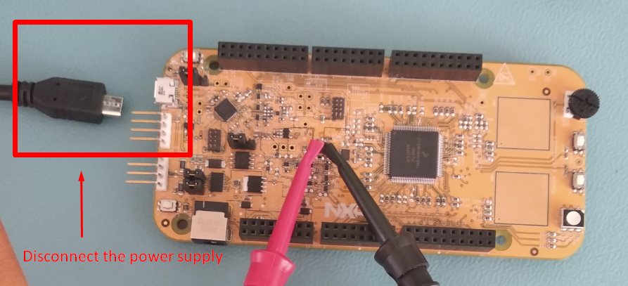

dianabatrlova
I have tested your code and still cannot reproduce your issue.
Please, see the steps after the load project:
I'm using OpenSDA UART.
1. Disconnect the power supply
2. Connect the power supply and press reset and press key number '6'

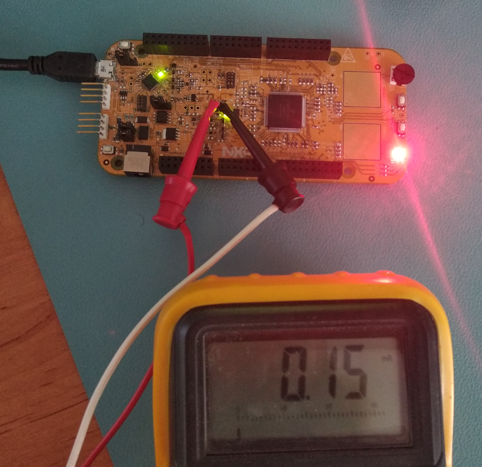

Also, I measure the current 0.15 mA which confirms that MCU is in VLPS mode:

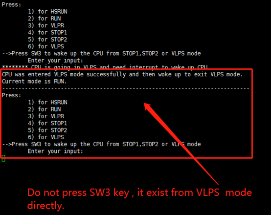

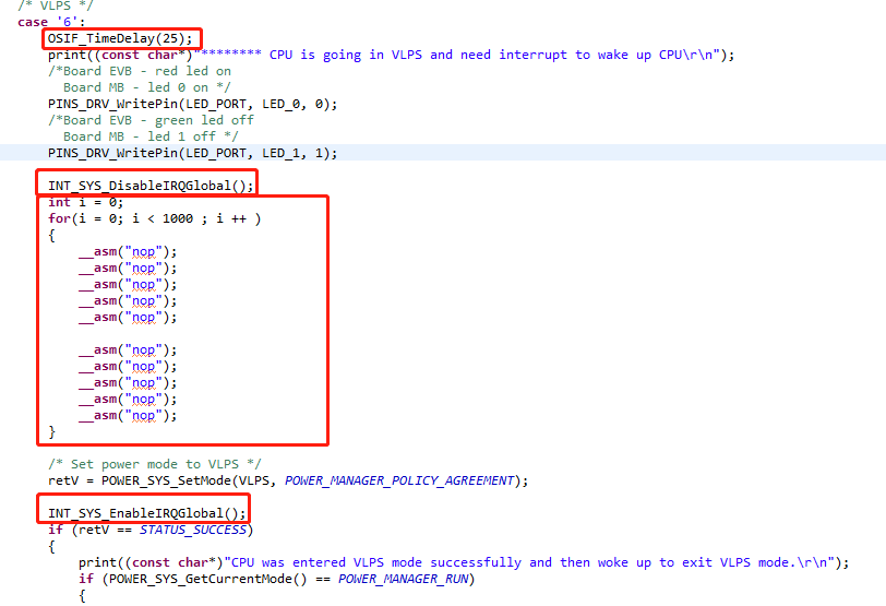

   Sorry,Maybe I didn't disconnect the power supply last time, causing problems.
   But,trouble you here is trying the code below:
 1 disconnect the debuger;
 2 disconnected the power supply;
 3 connect the power supply and reset;
 4 first ,it can enter VLPS, second ,it can not enter VLPS( exist from VLPS directly)。

dianabatrlova
In this case, It is woken up by the pending interrupt.

I would like to apologize for the delay. I recommend you to look at the ARMv7-M Architecture
Reference Manual https://static.docs.arm.com/ddi0403/eb/DDI0403E_B_armv7m_arm.pdf
In this case, the exception becomes pending after the global interrupts are disabled.
You can test that if you comment the INT_SYS_DisableIRQGlobal() function, the MCU enter VLPS successfully.
Note: The SysTick pending status can be clear by PENDSTCLR bit located in ICSR register. This bit removes the pending status of the SysTick exception.

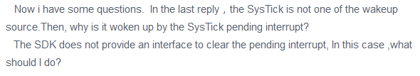

   Now i have some questions.  In the last reply,the SysTick is not one of the wakeup source.Then, why is it woken up by the SysTick pending interrupt?
   The SDK does not provide an interface to clear the pending interrupt, In this case ,what should I do?

If you are in debug mode and you enter to VLPS which is actually emulated stop state the core clock is enabled. That is mean the SysTick is enabled. In that case, the SysTick is wake up source and it will exit the emulated stop state.
If you do not have attached debugger the SysTick should be disabled and you should be able to enter VLPS.
