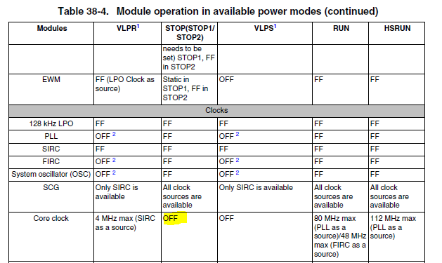

according to my understanding, in stop mode the SysTick should be disabled (since it's clocked from core clock):
Nevertheless, in my design (s32K11x) looks like It's nod disabled and it's able to exit from stop mode.
Is it due to the attached debugger?
Since the debugger interrupt is not mapped to NVIC I suppose it could be active, but if the core is stopped it shouldn't.

dianabatrlova
Hi Luca,
Yes, it is due to the attached debugger.
Please, refer to section "39.4.5 Debug in low power modes" in the RM rev 9.
... the mode controller handles attempts to enter STOP and VLPS by entering an emulated stop state. In this emulated stop state:
• all system clocks, except the core clock, are disabled,
I hope it helps.
