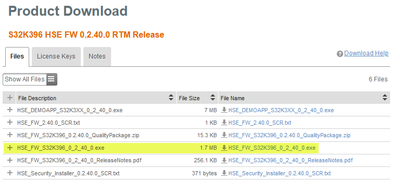

The INSTALL example shows how to install the firmware via IVT.
The HSE firmware can be downloaded from S32K3 Standard Software -> HSE Firmware:
https://www.nxp.com/webapp/swlicensing/sso/downloadSoftware.sp?catid=SW32K3-STDSW-D

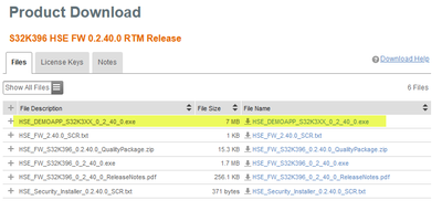

HSE DEMOAPP:
Can be downloaded from the same place as above:
It supports also S32K396.
There’s detailed description in the readme file, section “4. Setup”:
c:\NXP\HSE_DEMOAPP_S32K3XX_0_2_40_0\HSE_DEMOAPP_S32K3XX_0_2_40_0_ReadMe.pdf
It describes all the steps needed to make the demo work – including copying of HSE FW interface files etc.

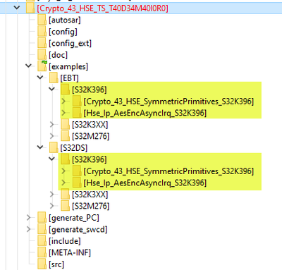

RTD examples:
Autosar Crypto driver in RTD contains examples written directly for S32K396:
There are versions for EB Tresos Configurator or for S32 Design Studio IDE.
And there’s one example for MCAL crypto layer and one example for lower non-autosar Ip layer.
