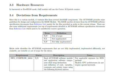

However, based on what I can see from the included examples, the 'BaseNXP' driver from the Non-Autosar layer is required in all cases. Is that right?
Yes, the BaseNXP module includes general AUTOSAR and hardware specific register files. Inside its user manual (RTD_BASENXP_UM.pdf), you can find the driver's deviations from requirements, driver limitations, and some other useful information:
