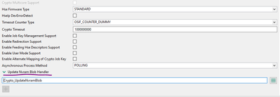

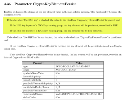

shravani
Hi @lukaszadrapa,
Can we use crypto key element persist feature to store user values to secure NVM?
shravani_0-1715161489713.pngshravani_0-1715161489713.pngshravani_1-1715161543209.pngshravani_1-1715161543209.png
I was checking Crypto driver persistent information in the RTD_CRYPTO_UM.pdf document. But I am confused. Please let me know your thoughts on this.
タグ(1)
6,645件の閲覧回数
lukaszadrapa
Hi @shravani
this is how the CryptoKeyElementPersist works:
You use HSE keys, so CryptoKeyElementPersist is ignored and you can load a key only to NVM or to RAM key catalog as usual.
Lukas
