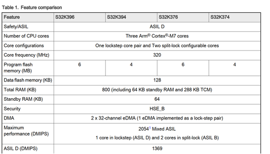

Performance of e200z759 will be around 2.27 DMips/MHz what gives 600 DMIPS per one core running at 264MHz. However MPC devices mostly haven't specified official numbers.
On the other hand S32K3 has it well defined in the datasheet as you can see below, separately for ASIL-B or D (i.e. whether these are variants with cores in lockstep or decoupled).
