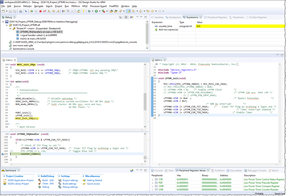

My usecase for the timer was to do some profiling of the code.As suggested i have made the modifications as below.
void LPTMR0_init(void)
    PCC->PCCn[PCC_LPTMR0_INDEX] = PCC_PCCn_CGC_MASK;
    // PCC->PCCn[PCC_LPTMR0_INDEX] = 0x0;
    // LPTMR0->PSR = 0;    /* Enable LPTMR Clock         */
    // LPTMR0->PSR |= LPTMR_PSR_PCS(0b01)                /* LPTMR clk src: 1KHz LPO */
                   // | LPTMR_PSR_PBYP_MASK;
    LPTMR0->PSR |= 0x4  ;                                /* Bypass Prescaler         */
    LPTMR0->CMR = 0x7;
                                    /* 500 ms interrupt         */
    LPTMR0->CSR |= LPTMR_CSR_TCF_MASK;    /*    Clear TCF flag by writting a logic one */
    LPTMR0->CSR |= LPTMR_CSR_TIE_MASK;                     /* Timer interrupt enabled */
    LPTMR0->CSR |= LPTMR_CSR_TEN_MASK;                  /* Enable Timer             */
    NVIC_init_LPTMR0_IRQs();
void LPTMR0_IRQHandler (void)
    if (0 != (LPTMR0->CSR & LPTMR_CSR_TCF_MASK)) //0x80u   1000 0000
        /* Check if TCF flag is set */
        // 0x80u   1000 0000
        counter_time++;
I have done the profiling but for some reason the timer does not start on power cycle.But if I connect the Jlink and give the command "rnh" to reset MCU the timer behave as expected.Any thought as to why?

Robin_Shen
Hi Vishal Roy,
I try to test the S32K116_Project_LPTMR example.
Only modify the LPTMR_init and LPTMR0_IRQHandler function.
When debug it on S32K116EVB with S32 Design Studio, it was able to works.
I did not put NVIC_init_LPTMR0_IRQs(); into LPTMR_init .
Robin

Robin_Shen
Sorry!
I input the wrong compare value, 1ms should input 1000.
LPTMR0->CMR = 0x1F3F;
The last compare value may too small(1us), the interrupt will enter too frequency.
This example does not contain printf function.
I try to toggle Blue LED every enter LPTMR0_IRQHandler 1000 times.
