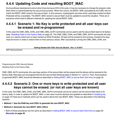

wang_q4
Hi Lukas,
Now, secure boot verfication is success,i update ted secure boot area code and update BOOT MAC success,but after reset,secure boot failed,What do we need to pay attention to update BOOT MAC
10,891 Views
lukaszadrapa
this is described in AN5401:
Lukas
