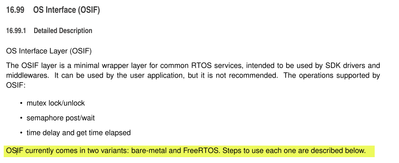

I transplanted the SDK CSEC Driver to the normal project (without free RTOS) for use. The chip objects are S32K142 and S32K146. I found that the SDK CSEC Driver only used the OS timer for timeout processing, so my solution was to delete the OS part of the CSEC Driver C file, which met my needs.

Q:What I want to inquire about is transplanting the SDK CSEC Driver to the Normal project (142/146, no OS). Are there any potential risks? ?

lukaszadrapa
Hi @Gideon
there's implementation of OSIF for both FreeRTOS and baremetal configuration. So, there's no problem even if you don't use FreeRTOS. Take a look at section "OS Interface (OSIF)" in SDK user manual.
I can't see a reason to do such changes.
And if SDK is not used ever, it's better to use code from AN5401.
Lukas

Q1:Where can I view the document you sent a screenshot of?
Q2:Could you provide me with a baremetal configuration S32K14x CSEC driver?

You can find the manual here:
c:\NXP\S32DS.3.4\S32DS\software\S32SDK_S32K1XX_RTM_4.0.3\doc\S32SDK_S32K144_UserManual.pdf
No configuration is needed. If you have a project without FreeRTOS then baremetal version is selected automatically.
