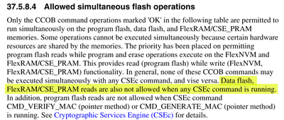

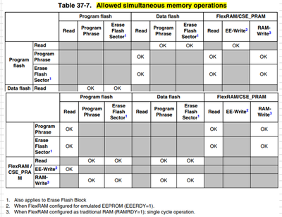

A2: IBUSSERR
By the way Viewed the manual S32K-RM.pdf Table 37-7. Allowed simultaneous memory operations,
There are limitations in operating CSE PRAM on D-Flash,Could IBUSSERR be related to this?
4,735 Views
lukaszadrapa
I haven't met this use-case yet but I can see in the manual that you are right. It explicitly says:
 If your code is running from data flash, solution is to put the function to RAM memory.
