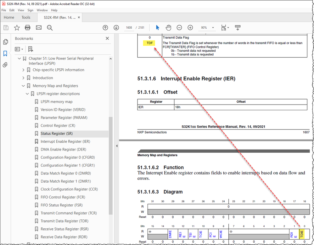

Will setting the SPI ier to TDIE position 1 cause the SPI controller to send an interrupt request to the NVIC;1.png

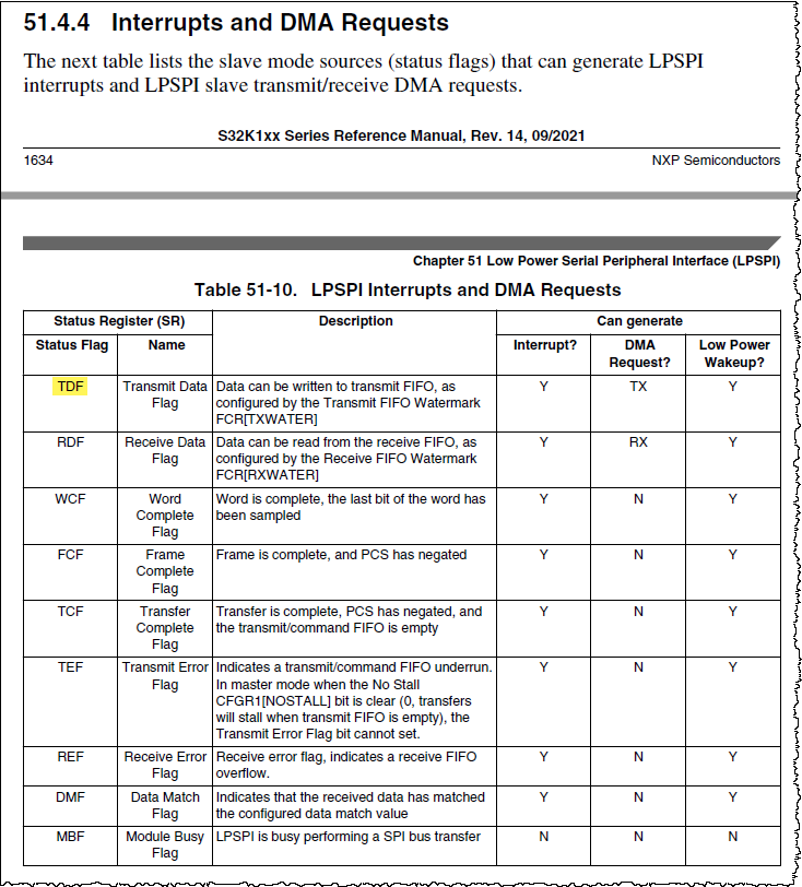

Hi qiansan,
You can see the condition that triggers the interrupt from the section 51.3.1.5 Status Register (SR) and 51.4.4 Interrupts and DMA Requests of S32K1xx MCU Family - Reference Manual
.TDF 51.3.1.5 Status Register (SR).png51.4.4 Interrupts and DMA Requests.png
