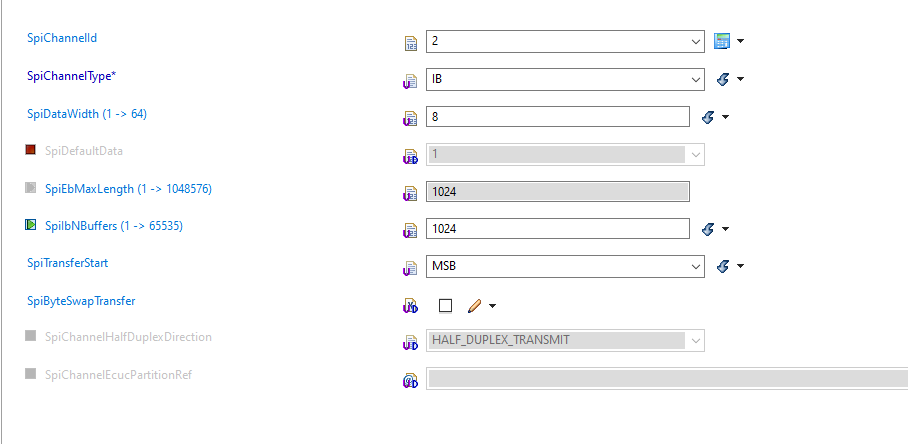

I would like to know how can I configure the DMA with SPI using Tresos for S32K344.
SW. Version: 4.0.0 HF02_D2407.
I'm trying to configure but I cannot see signal on bus looking the logic analyzer.
Should I configure the channel as IB or EB?
When I remove the DMA, it works properly.
Piece of code that I try to send message:

Hello @VaneB ,
I found the issue,
In my code I was sending 256 bytes, not 1024. When I changed it to 256 it worked. Do you know if it is possible for this value to be adaptable at runtime like in the EB type?
When we select the EB type, we can choose the maximum number of bytes to be sent.

Hi @MVR
I am afraid that there is no function available to change the SpiIbNBuffers at runtime.

Some pictures of DMA configuration:
Platform module:
SPI module:
