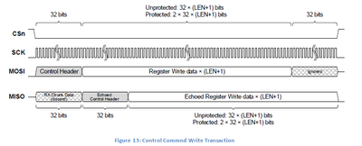

I am implementing SPI communication between the S32K144 MCU and MAC-PHY (LAN8650).
For Control Transaction Write/Read (where the master writes/reads a register value to/from the slave), the process follows the TC6 SPI protocol as shown in the image below:
Before stepping forward to actual register read/write to MAC-PHY, I thought of testing it with some dummy data and verify it by probing in at MOSI of S32K144 and SDI of MAC-PHY(LAN8650) chip. With that I could successfully send 16 bit and 32 bit data, but whereas no data transactions happening for 64 bit transfer.
As per above picture inorder to read/ write the slave register it should be 64 bits(Control header + Data) or higher.

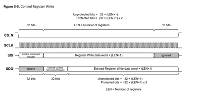

code looks normal, but I think a protocol looks little bit different. There should be 3 words transferred for single register writing/reading
For both read and write, the Control Header sent to the LAN8650/1 over SDI is always echoed back to the SPI host over SDO. When performing control writes, the register data sent over SDI is also echoed back over SDO.
Thus for write you send header, data, dummy words, For read you send header, dummy, dummy words.
So try that, measure SPI lines with scope /analyzer to know real frames. Also check header is correct.

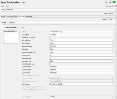

I'm responding to your post as I have experience implementing the TC6 protocol using the LAN8651 MAC-PHY chip from Microchip on the S32K314 MCU.
In my case, I used RTD 4.0.0 with S32 Design Studio 3.5, and configured the LPSPI driver as follows.
Based on this LPSPI driver, you should be able to configure a uint8_t tx and rx buffer with 12 elements and perform SPI communication accordingly.
ex) uint8_t spiRxBuffer[12], uint8_t spiTxBuffer[12]

Muthappan_Viswanthan
Thanks for your reply. Rightnow, Iam using older version of S32 DS and doing baremetal programming. But thought of switching to newer version and using RTD, this might helpful for me in that case. Thanks again!

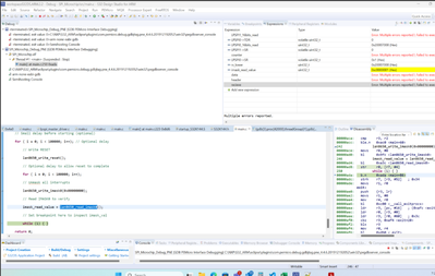

I used 2 a) [ set FRAMESZ to 31 for 32bit frame size and control CS manually and fill data registers as per desired number of word transfer.] with some dummy data and it worked. Now, when I tried with my actual task where I need to communicate with LAN8650 chip, I should write/read by sending control header first where the respective address should be present:
For this purpose I used the below code :

Here, I am trying to Write 0x00000000 to IMASK0 register address and trying to readback the same address in order to ensure the value has been written properly. But I got value has 0xC0000001 instead of 0xC0000000. (IMASK0 has 31 to 16 bits as reserved and Read-Only bits thus 0xC000 can be fixed even i try to write it as 0, thus we can neglect that) But the lower 16 bits are R/W and thus it should be 0.
For debugging purpose, in the above code I set breakpoint in the last while loop and it successfully hits (above picture) thus seems like write and read happening proper (not 100% sure, my assumption) but the value read is wrong.

As per the statement from LAN8650 datasheet "When performing control writes, the register data sent over SDI is also echoed back over SDO", I am not getting echoed data as same as what I transmitted during write and read operations.
