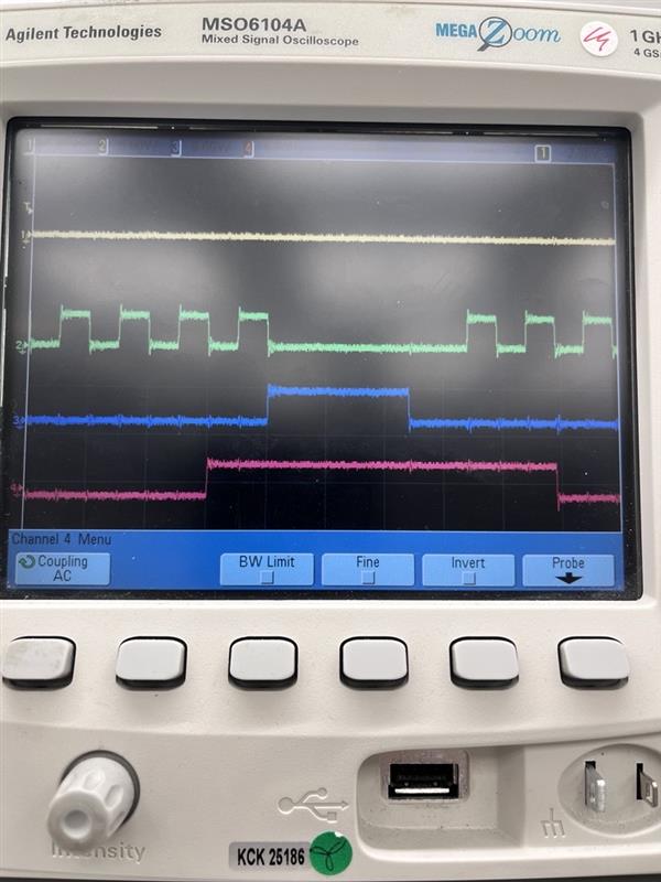

I am implementing SPI communication between the S32K144 MCU and MAC-PHY (LAN8650).
For Control Transaction Write/Read (where the master writes/reads a register value to/from the slave), the process follows the TC6 SPI protocol as shown in the image below:
Before stepping forward to actual register read/write to MAC-PHY, I thought of testing it with some dummy data and verify it by probing in at MOSI of S32K144 and SDI of MAC-PHY(LAN8650) chip. With that I could successfully send 16 bit and 32 bit data, but whereas no data transactions happening for 64 bit transfer.
As per above picture inorder to read/ write the slave register it should be 64 bits(Control header + Data) or higher.
The working code 32 bits dummy data transfer is as follows :

Note : For 64 bit data transfer, I changed TCR[FRAMESZ]=3F and changed respective data types and values.
My questions are:
1. Is S32K144 doesnt support whole 64 bit transfer in one go? [In S32K1xx Series Reference Manual, Rev. 14 at start of page 1623 it means as the maximum frame size is 32 bits?]
2. If it supports only 32 bits, then kindly help me the way that on how to transfer >=64 bits of data.
3. Else if it supports 64 bits, then kindly point me out the changes i have to perform in the above code.
Thanks in advance!
8,395件の閲覧回数
PetrS
code looks normal, but I think a protocol looks little bit different. There should be 3 words transferred for single register writing/reading
For both read and write, the Control Header sent to the LAN8650/1 over SDI is always echoed back to the SPI host over SDO. When performing control writes, the register data sent over SDI is also echoed back over SDO.
Thus for write you send header, data, dummy words, For read you send header, dummy, dummy words.
So try that, measure SPI lines with scope /analyzer to know real frames. Also check header is correct.
BR, Petr

PetrS
yes, lpspi allows sending/receiving frame that has size larger that 32 bits. There could be several ways to do that.
1. set FRAMESZ to be multiple of 32, as per your need, how many words have to be transferred (up to 128)
2. set FRAMESZ to 31 for 32bit frame size and
a) control CS manually and fill data registers as per desired number of word transfer. You can refer to below code
https://community.nxp.com/t5/S32K/S32K146-LPSPI-with-ADXL314/m-p/1826209/highlight/true#M32845
b) use continuous selection, refer to https://community.nxp.com/t5/S32K/Continuous-Transfer-LPSPI-S32K14x/td-p/1830165
For sure above codes need to be modified for 32bit transfer.
Hope it helps.
BR, Petr

Muthappan_Viswanthan
I used 2 a) [ set FRAMESZ to 31 for 32bit frame size and control CS manually and fill data registers as per desired number of word transfer.] with some dummy data and it worked. Now, when I tried with my actual task where I need to communicate with LAN8650 chip, I should write/read by sending control header first where the respective address should be present:
For this purpose I used the below code :

And I measured the SPI lines of LAN8650 with scope and the observations are:
1. CS is LOW for the entire duration of 3x 32bits transfer.
2. SCK not seems to be continuous. After each 32bits transfer SCK is in LOW for some time and then starting back. [Refer below picture channel 2 (green) waveform ]
3. SDI line has the same 32bit header, 32 bit data and 32 bit dummy data which I sent from S32K144 MOSI.
4. SDO echoes "0xC000 0000" during header transmission (Ignored data),  "0xC000 0001" during both data & dummy data transmission which expected to be header & data as per datasheet.
The header seems to be correct, example I used "0x30000c00" for IMASK0.
So, whether that delay in SCK between each 32 bits makes an issue?

a delay in SCK should not be an issue. Check if there are right number of clock periods in words.
To say more capture full frame in scope/analyzer.
I guess you have wrong parity bit calculated. You wrote "The header seems to be correct, example I used "0x30000c00" for IMASK0." But this time parity bit should be set to have odd number of "1" in header.
BR, Petr

Finally its working and the issue is with header as you stated. Actually, I read like we should set the parity bit to "1'" if we have odd number of 1's between bit 31:1 and thus in my case I didnt set it. After your comment I just deep dive into it and got to know that my understanding is wrong. Thanks for lightning up.!
