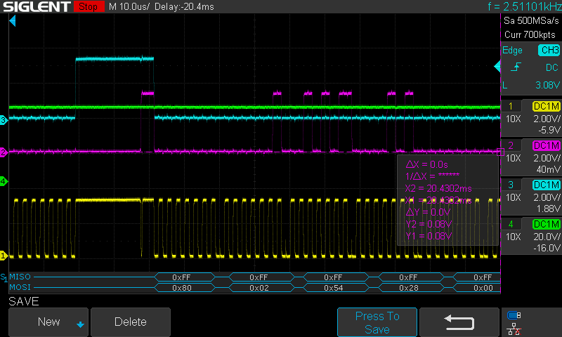

We're having an issue with our MR_CANHUBK344 evaluation board running Zephyr OS. The SPI clock pulses are cut off after the end of each 8-bit word. We aren't sure why this is happening or what we might need to change to fix it.
not sure of the config you have, so try to check CCR, CCR1 and TCR registers, eventually adjust parameters in it. See more in chapter 70.3.1.3 Timing parameters of the device RM.
BR, Petr
