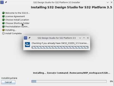

@dsantxez I am also facing the same issue when trying to install S32 Design Studio 3.5 in my linux pc, how did you resolve the issue?
Any help would be appreciated.

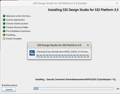

dsantxez
It does not continue after this screen. I have tried introducing a valid activation key and invalid key and I get the same result.

petervlna
Ok,  looks to me like your PC is not able to connect to our server for some reason to verify the license.
Do you use any firewalls, etc? Consult this issue with your IT department.
Also try to install it on another PC to see if the issue persist.

dsantxez
Thank you for your reply. This happens at my home laptop but if I try to do it in Windows in the same laptop it works.
Maybe as you said it has to do something with the firewall configuration in Linux. Could you tell me the service IP and port to see if I have that somehow blocked in my Linux installation?

dsantxez
The problem is that once I put the activation code, I don't get that next window telling me Online or Offline option. I get the following:

petervlna
To me its still looks like Firewall blocking access to NXP license server. So you are not even able to connect there and inset key.
@jiri_kral do we have some recommendation for firewall setting / port on linux for our license servers?

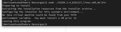

dsantxez
I have tried installing the 3.4 version but it says that there is no JAVA VM installed, but there is installed in the system.
I have tried both 11 and 17 version of JAVA.
