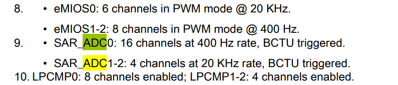

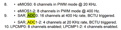

Attached is a snapshot from S32K3xx datasheet regarding ADC channels and PWM. Is this same configuration applicable for S32K312? For example: ADC0: 16 channels at 400Hz and ADC1: 4 channels at 20kHz?

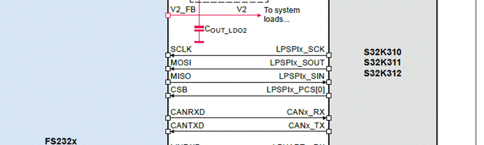

As per the snapshot attached, LPSPIx_SOUT  -> MOSI and LPSPIx_SIN -> MISO. Is this configuration correct or need to be reversed?

Regarding ADC and PWM, we would like to know the corresponding channels that support 20kHz frequency and 400Hz frequency.
As per the snapshot provided, it shows ADC0 has 16 channels that supports 400Hz and ADC1-2 has 4 channels that supports 20kHz. But this is not applicable to S32K312. Could you please provide the frequency of ADC and PWM channels that supports S32K312?

Hi again,
Regarding the previous datasheet's screenshot, there are conditions on which the power mode tests are based. They are not specifications of the eMIOS and ADC modules as such.
eMIOS in PWM mode can archive the core frequency, which for S32K312 is 120MHz.
For ADC specifications please refer to Table 35. SAR_ADC of datasheet.
I hope this information is helpful.
Leonardo

_Leo_
Thank you for your interest in our products and for contributing to our community.
SPI configuration is correct.
Regarding ADC and PWM, please provide more details about your inquiry.
