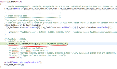

When initializing FCCU, it jumps to the BusFault_Handler. The following is the error location.
Please help me resolve it. Thank you.

I'm not step debugging FCCU
After execution, the program will automatically abort and jump to BusFault_Handler
It stops at the following code
addr = ERM_SR_ADDR32( au32InstanceBaseAddr[u32i], u8j );
What parts do I still need to check?
I can run normally on SPD 1.0.2 and RTD 2.0.3.
I am currently using SPD 1.0.3 and RTD 3.0.0.

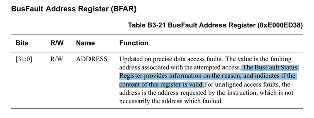

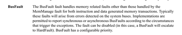

To find the reason of your bus fault please check the BusFault Status Register and BusFault Address Register. I expect you are writing to protected area. For example FCCU registers which are not unlocked, etc...

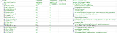

iverson3ya
I'm not sure if I'm checking it correctly, but it seems like all the values inside are 0. I still don't know the reason behind this.

You are looking at CFSR register.
What is the content of BFSR?
Please refer to my explanation above.

The BFAR is 0x00 in the upper image, and I did not observe the BFSR.
