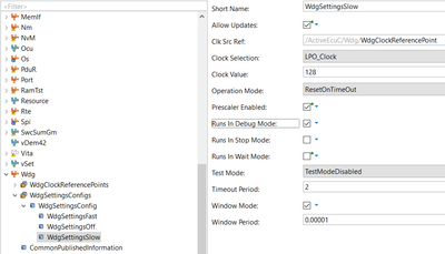

As per S32K1xx Series Safety Manual, Rev. 4, 09/2018 document for SM_048, DBG bit in the Watchdog Control and Status Register (CS) should be set to 1 and we are also using LPIT then LPIT_MCR[DBG_EN] = 1.
I am able to set the DBG bit to 1 by configuring the Wdg Run in debug mode parameter as shown below
but when I try to set LPIT_MCR[DBG_EN] = 1, then my application is continuously resetting and LPIT_MCR[DBG_EN] bit is never getting set to 1.

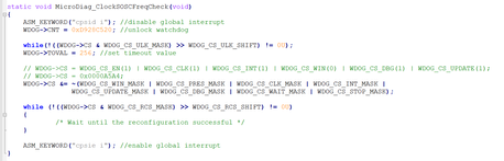

I am able to set LPIT_MCR[DBG_EN] bit to 1, but I am not able to set WDOG ->CS[DBG] = 1 from the code, these bits are only getting set only from the configuration, is there any way I can set it manually.
Source code I am using to set the WDOG ->CS[DBG]  = 1
WDOG ->CS = 0x0000A5A4;

In the initial initialization of the WDOG, you need to set the UPDATE bit.
So, before you write the register, read it first, is UPDATE = 1?

I forgot to mention that the WDOG must be unlocked first.

I have tried the suggested solution but I am not able to set WDOG ->CS[DBG] = 1, kindly find the below code for reference

danielmartynek
Hello Manish,
Please double-check the code, it clears both DBG and UPDATE.

manish_singh
@danielmartynek
I have updated the code but then also it was not getting set. Can we have a meeting to discuss on this ?
