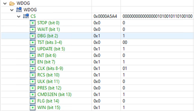

As per S32K1xx Series Safety Manual, Rev. 4, 09/2018 document for SM_048, DBG bit in the Watchdog Control and Status Register (CS) should be set to 1 and we are also using LPIT then LPIT_MCR[DBG_EN] = 1.
I am able to set the DBG bit to 1 by configuring the Wdg Run in debug mode parameter as shown below
but when I try to set LPIT_MCR[DBG_EN] = 1, then my application is continuously resetting and LPIT_MCR[DBG_EN] bit is never getting set to 1.
Can you please let me know the correct procedure to set LPIT_MCR[DBG_EN] bit and also the implementation support to meet SM_048 requirement.

manish_singh
Hi Daniel,
I am able to set LPIT_MCR[DBG_EN] bit to 1, but I am not able to set WDOG ->CS[DBG] = 1 from the code, these bits are only getting set only from the configuration, is there any way I can set it manually.
Source code I am using to set the WDOG ->CS[DBG]  = 1
WDOG ->CS = 0x0000A5A4;

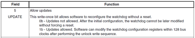

danielmartynek
Hi @manish_singh,
In the initial initialization of the WDOG, you need to set the UPDATE bit.
So, before you write the register, read it first, is UPDATE = 1?
BR, Daniel

danielmartynek
I forgot to mention that the WDOG must be unlocked first.
5,117 Views
