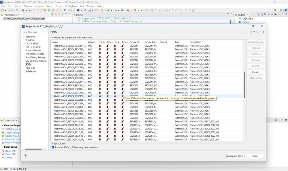

I am trying to create an example application project for LED blinking for S32K358. When creating a project, I am not able to attach the SDK and it shows the error that "SDK cannot be attached as it does not support the toolchain required by the project".
I have installed S32DS 3.6.4. Have installed SDK "SW32K3_RTD_4.4_2.0.0_DS_updatesite_D2204.zip"Error_1.png

Hello Robin,
Thank you for your response. Could you please send the link to the latest RTD that will be supported with 3.6.4 S32DS IDE.
Also in your step 3, I do not see any SDK to attach. It shows empty list.

Click S32K3 Standard Software -> Automotive SW - S32K3/S32M27x - Real-Time Drivers for Cortex-M -> S32K3_S32M27x Real-Time Drivers ASR R21-11 Version 6.0.0
By the way, the latest S32K3 RTD 6.0.0 was tested in S32 Design Studio 3.6.1. I have not tried to install S32K3 RTD 6.0.0 in S32DSv3.6.4.

1. I don't recommend installing an older version like "SW32K3_RTD_4.4_2.0.0_DS_updatesite_D2204.zip."
2. Is there any special reason for needing such an old RTD version? Otherwise, I recommend installing the latest version, "SW32K3_S32M27x_RTD_R21-11_6.0.0_D2506_DesignStudio_updatesite.zip."
3. Go to File -> New -> S32DS Application Project, select S32K358, and then click ... to choose the SDKs. I recommend selecting it at that time.
