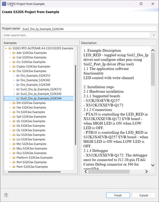

I suppose that you are using the examples provided in S32K344 Whiteboard Example Project.
Additionally you could refer to the example project for S32K344 that are included in the RTD:
Hope it helps you.
Have a nice day!
