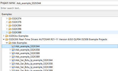

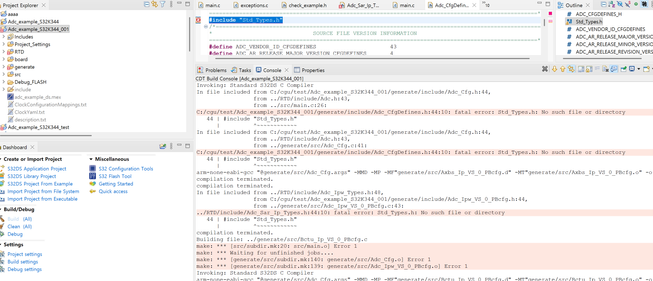

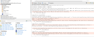

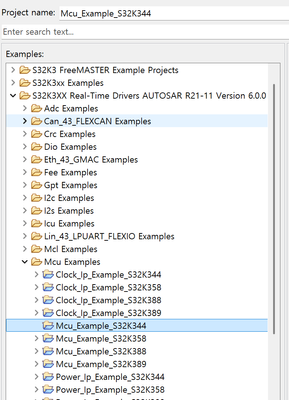

with S32 Design Studio, I was trying to build the example code.
but most of all example codes show build error.
Do I have to do something before build?
1. adc_example_S32K344
2.mcu_example_S32K344
===========build result ================================

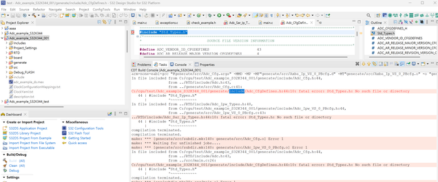

[Test 1] I have tried <S32 Configuration Tools> -><Manage SDK Components> (but changed nothing) and Click <Update Code and Build Project> , But meet another Errors.
[Test 2] I have tried <S32 Configuration Tools> -><Manage SDK Components> (add [adc] driver ) and Click <Update Code and Build Project> , But meet another Errors.
Could you help me?
[Test 1] - change nothing
== Build Result . Errors =====
[Test 2] - add [adc] driver

JungkyuHan1
Dear @Robin_Shen
I have tried copycat with the video you uploaded but failed(same result).
