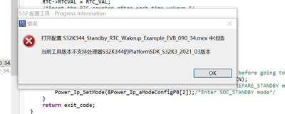

Hello, there is a routine to wake up S32K344 by GPIO, using EB tool configuration routine
10,822件の閲覧回数
1260784871
