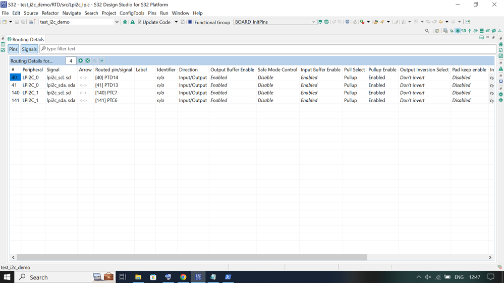

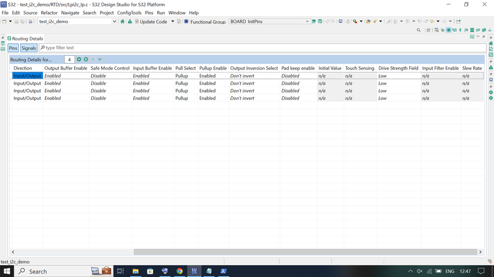

In your S32K314 project, I would check the SIUL2 MSCR registers whether the PTD13, PTD14 pins are muxed to LPI2C0, and whether the output / input buffers (OBE, IBE) are set.
You could also add the internal pull-up on those pins (PUE, PUS).
5,148 Views
anoop_r
Hi Daniel,
Thanks for responding to this and sorry for the delay.
In the device, I have added the pullup in both SCL & SDA on the master side even when the loopback is removed.
I also added the internal pull-up on those pins (PUE, PUS).
Screenshot (75).pngScreenshot (75).pngScreenshot (76).pngScreenshot (76).png
