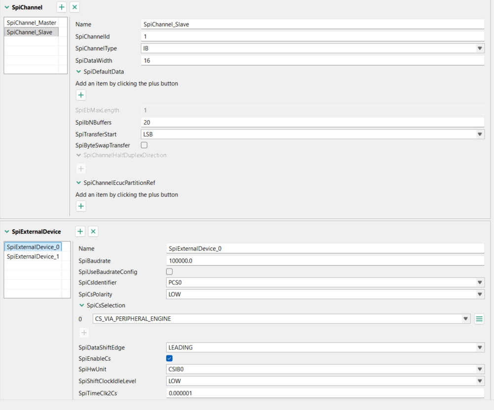

Hello @nxp
       I am configured in SPI in S32k31xevb board, I am getting SPI_JOB_PENDING. i connected the PINs correctly. what will the problem in this? i attached my project in here .  provide solution for this problem.

Hi @dhanabharathi
I have reviewed your configurations and noticed an important detail: the SPI master and slave are set with different baud rates.
Both devices should operate at compatible speeds. Since the master provides the clock signal, the slave must be able to reliably receive and respond at that rate. A mismatch in baud rates can lead to data corruption, communication errors, or complete failure to establish a connection.
BR, VaneB

dhanabharathi
Hello @VaneB ,
  I changed both SPI master and slave baud rates, but still the problem exists. can you please recheck.

VaneB
Hi @dhanabharathi
I have ported the Spi_Transfer_S32K344 project to the S32K311. To help ensure that no configurations, initializations, or code elements are missing from your setup, I am attaching both the .mex file and the main source file for your reference.

dhanabharathi
Hello @VaneB ,
  Now, it is working. Thank you for your support.
