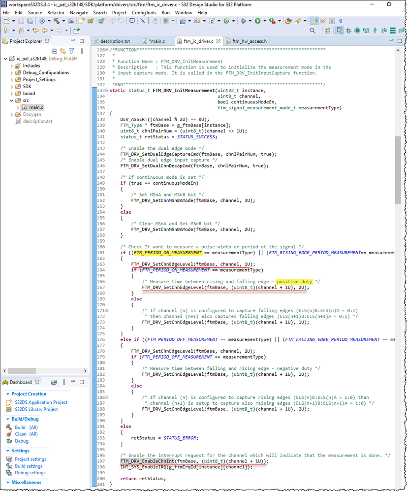

Robin_Shen
You don't need to connect signal at CH5.
FTM_DRV_InitMeasurement enable the channel (n+1) CHIE = 1
It should call "FTM_DRV_InputCaptureHandler" only when we have falling edge in the CH5.
Would you please set breakpoint to check the register value CHIE\ELSB:ELSA of CH4 and CH5?
Even if first_event_time and second_event_time have same time counts, the measurementResults[channel] should be ftmModValue.

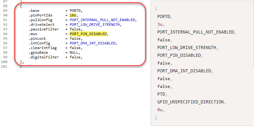

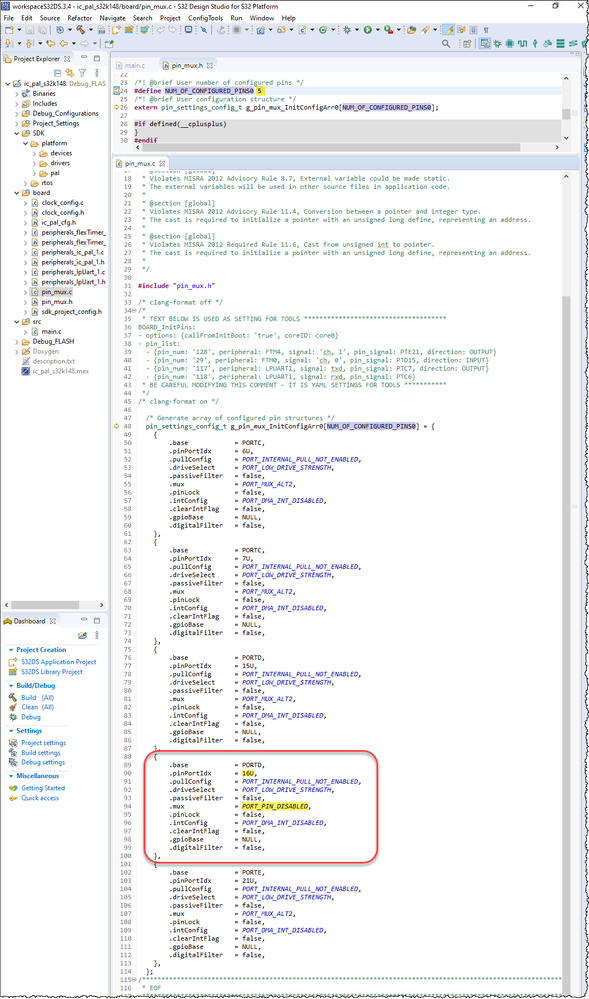

Robin_Shen
I test ic_pal_s32k148 example on S32K148EVB. Connect signal on PTD15(FTM0_CH0) will run into FTM_DRV_InputCaptureHandler. Connect signal on PTD16(FTM0_CH1) will not run into FTM_DRV_InputCaptureHandler.
Please check the value of PORT_PCR PTD16. If you don't use channel n+1 pin, the S32DS will not generate codes for this pin.
I don't know why you have below codes:
 PORTD,
 3u,
 PORT_INTERNAL_PULL_NOT_ENABLED,
 false,
 PORT_LOW_DRIVE_STRENGTH,
 PORT_PIN_DISABLED,
 false,
 PORT_DMA_INT_DISABLED,
 false,
 false,
 PTD,
 GPIO_UNSPECIFIED_DIRECTION,
 0u,

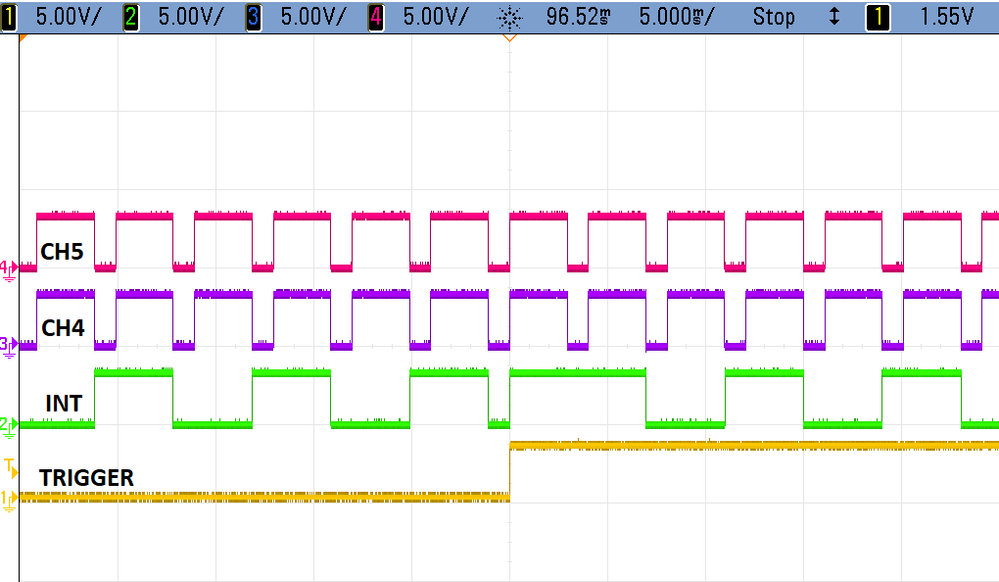

We planning to have Encoder signal connected to both PTD2(FTM3_CH4) and PTD3(FTM3_CH5), if required we will use GPIO Interrupt on edges to compute the ON/OFF time of encoder (as a backup).
When we have PTD3(FTM3_CH5) connected to the Encoder Signal though we configured or not this PRD2 in the pins mux randomly (with in one hour execution 10 times) we are hitting "FTM_DRV_InputCaptureHandler" and at that time we are seeing  error_count is incrementing (below code add in the "FTM_DRV_InputCaptureHandler" for testing):
        // Toggle the Pin PORT-E10 upon CH4 and CH5 Timer counts are same.
        if (first_event_time == second_event_time){
            error_count++;
            if (toggle_sp0){
                toggle_sp0 = false;
                PTD->PCOR |= 1<<28;
            }else{
                toggle_sp0 = true;
                PTD->PSOR |= 1<<28;
Same is not hitting when we are not connected this PTD3(FTM3_CH5) for 24hrs of execution.
As per the Reference manual PTD3(FTM3_CH5) will be ignored, but that is not the case here.
We need NXP thoughts on this PTD3(FTM3_CH5) encoder signal connected with pin not configured in recommended or not.
Also find the attached waveform:
CH4 and CH5 are Encoder Signal, INT is GPIO Toggle and TRIGGER is Error Toggle in the "FTM_DRV_InputCaptureHandler".

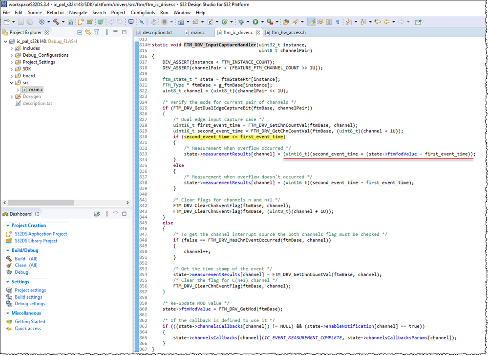

Here is the modified  "FTM_DRV_InputCaptureHandler" code:
static void FTM_DRV_InputCaptureHandler(uint32_t instance,
                                        uint8_t channelPair)
    DEV_ASSERT(instance < FTM_INSTANCE_COUNT);
    DEV_ASSERT(channelPair < (FEATURE_FTM_CHANNEL_COUNT >> 1U));
    ftm_state_t * state = ftmStatePtr[instance];
    FTM_Type * ftmBase = g_ftmBase[instance];
    uint8_t channel = (uint8_t)(channelPair << 1U);
    // Toggle Pin PORT-D24 upon interrupt (Named INT in the capture)
    if (toggle_sp1){
        toggle_sp1 = false;
        PTB->PCOR |= 1<<16;
    }else{
        toggle_sp1 = true;
        PTB->PSOR |= 1<<16;
    /* Verify the mode for current pair of channels */
    if (FTM_DRV_GetDualEdgeCaptureBit(ftmBase, channelPair))
        /* Dual edge input capture case */
        uint16_t first_event_time = FTM_DRV_GetChnCountVal(ftmBase, channel);
        uint16_t second_event_time = FTM_DRV_GetChnCountVal(ftmBase, (uint8_t)(channel + 1U));
        if (second_event_time <= first_event_time)
            /* Measurement when overflow occurred */
            state->measurementResults[channel] = (uint16_t)(second_event_time + (FTM_DRV_GetMod(ftmBase) - first_event_time));
        else
            /* Measurement when overflow doesn't occurred */
            state->measurementResults[channel] = (uint16_t)(second_event_time - first_event_time);
        /* Clear flags for channels n and n+1 */
        FTM_DRV_ClearChnEventFlag(ftmBase, channel);
        FTM_DRV_ClearChnEventFlag(ftmBase, (uint8_t)(channel + 1U));
        // Named TIGGER in the Capture
            error_count++;
            if (toggle_sp0){
                toggle_sp0 = false;
                PTD->PCOR |= 1<<28;
            }else{
                toggle_sp0 = true;
                PTD->PSOR |= 1<<28;
        encoder_val[encoder_index++] = state->measurementResults[channel];
        if (encoder_index >= ENCODER_ARRAY_MAX){ encoder_index = 0U;}
    else
        /* To get the channel interrupt source the both channels flag must be checked */
        if (false == FTM_DRV_HasChnEventOccurred(ftmBase, channel))
            channel++;
        /* Get the time stamp of the event */
        state->measurementResults[channel] = FTM_DRV_GetChnCountVal(ftmBase, channel);
        /* Clear the flag for C(n+1) channel */
    /* If the callback is defined to use it */
    if (((state->channelsCallbacks[channel]) != NULL) && (state->enableNotification[channel] == true))
        state->channelsCallbacks[channel](IC_EVENT_MEASUREMENT_COMPLETE, state->channelsCallbacksParams[channel]);
Pratap Metharamitta

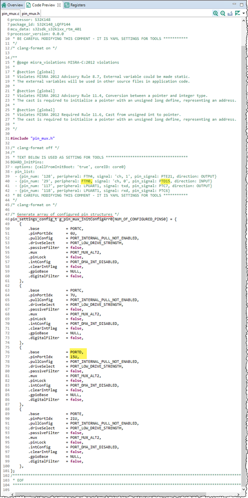

Robin_Shen
Sorry for the delay!
Please check the value of PORT_PCR PTD3.
I try to add PTD16 into g_pin_mux_InitConfigArr0, did not find the issue on ic_pal_s32k148 example.
Your code structure looks different from the pin_settings_config_t of the SDK. Would you please let me know the version of your SDK?
You can also attach your test project, so that I can direct test it.

Robin_Shen
FTM_SIGNAL_MEASUREMENT configure FTM as dual edge input capture(Dual Edge Capture Mode).
Check the channel ID need to even number in the measurement mode.
        if (second_event_time < first_event_time)
        else
first_event_time  and second_event_time have same time counts.
