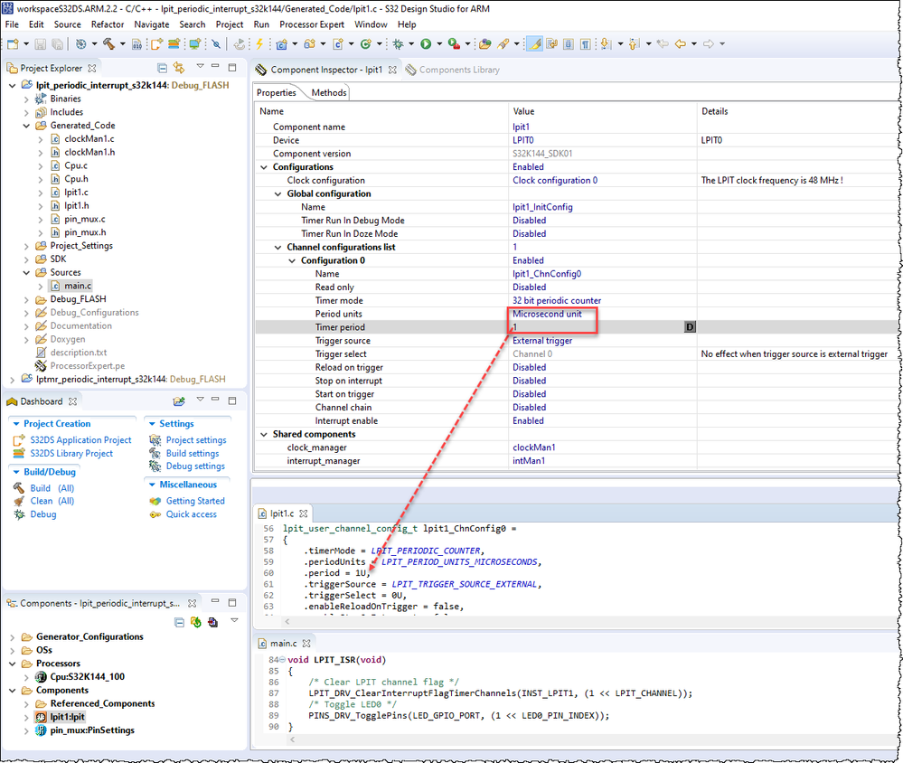

Is it possible to generate 1ms  timer interrupts using s32k144 micro?
4,588 Views
Robin_Shen
Hi ABDERRAHIM JAMAOUI,

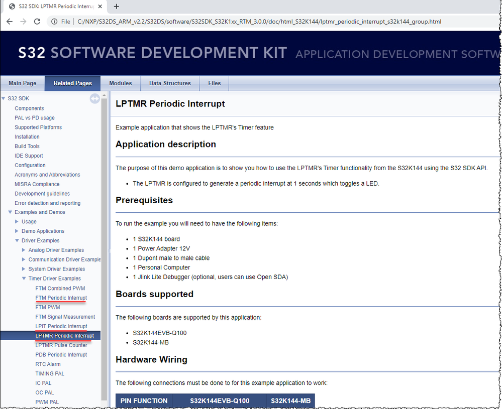

Several timers can be used to generate 1ms interrupt.
You can refer the modification of lpit_periodic_interrupt_s32k144.
