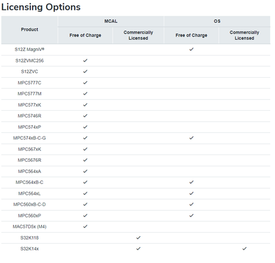

kmh48301
Hi.
Thanks for replying.
If i want to use the FEE module, do i have to pay?
I found this on your link.
i have s32k144 evb. Can i use the fee module?
Best Regards
Phillip
6,477 Views
hungnguyenphi
Hello @kmh48301 ,
With the S32K1 MCAL package, NXP will provide 3 months evaluation license and after that user will need to buy a DISM license for using this package.
Hung

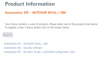

kmh48301
Hello, @hungnguyenphi
How can I get the 3 months evaluation license?
Best Regards
Phillip
6,456 Views
hungnguyenphi
Hello @kmh48301 ,
The evaluation License will appear in the link where you download the package.
Hung
6,453 Views
kmh48301
I found it.
Thank you so much.
