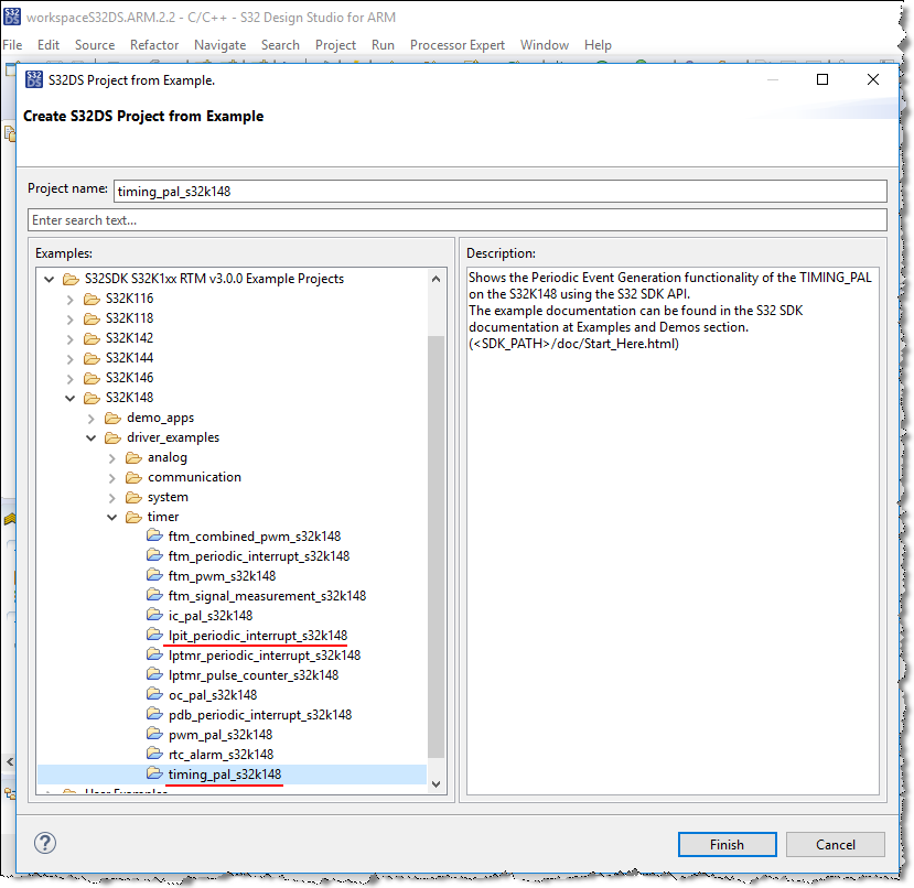

Please download the latest S32 Design Studio for ARM 2.2 – Windows/Linux(REV 2.2), then you can refer these timer examples of S32K148.
